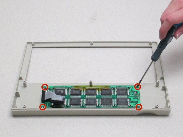

    3. AlphaSmart Pro Front Panel Replacement, Removing Display Screen: crwdns2935265:03crwdnd2935265:01crwdnd2935265:03crwdne2935265:0 AlphaSmart Pro Front Panel Replacement, Removing Display Screen: crwdns2935265:03crwdnd2935265:02crwdnd2935265:03crwdne2935265:0 AlphaSmart Pro Front Panel Replacement, Removing Display Screen: crwdns2935265:03crwdnd2935265:03crwdnd2935265:03crwdne2935265:0
      • Looking at the front panel, use the Phillips #00 screwdriver to remove the four Phillips head 0.8 cm screws from each corner of the display motherboard.

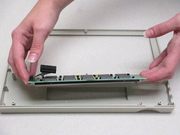

      • Lift the display screen and motherboard from the plastic front panel to separate the two pieces.
