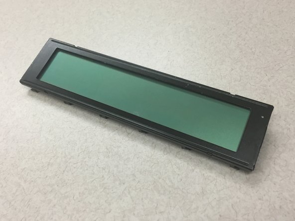

    3. AlphaSmart Pro Display Screen Replacement, Removing Display Screen: crwdns2935265:03crwdnd2935265:01crwdnd2935265:03crwdne2935265:0 AlphaSmart Pro Display Screen Replacement, Removing Display Screen: crwdns2935265:03crwdnd2935265:02crwdnd2935265:03crwdne2935265:0 AlphaSmart Pro Display Screen Replacement, Removing Display Screen: crwdns2935265:03crwdnd2935265:03crwdnd2935265:03crwdne2935265:0
      • Looking at the front panel, use the Phillips #00 screwdriver to remove the four Phillips head 0.8 cm screws from each corner of the display motherboard.
      • Lift the display screen and motherboard from the plastic front panel to separate the two pieces.

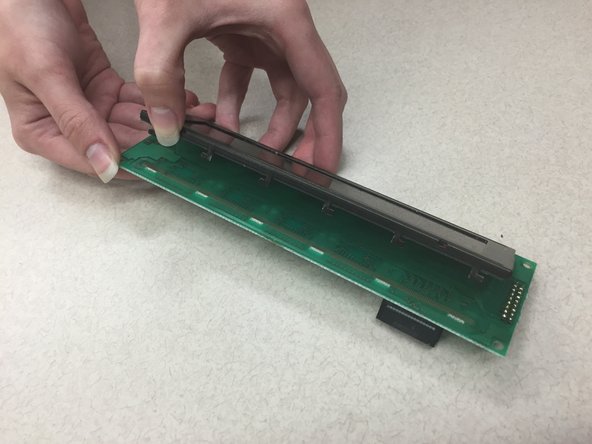

    1. AlphaSmart Pro Display Screen Replacement, Removing Small Motherboard: crwdns2935265:04crwdnd2935265:01crwdnd2935265:03crwdne2935265:0 AlphaSmart Pro Display Screen Replacement, Removing Small Motherboard: crwdns2935265:04crwdnd2935265:02crwdnd2935265:03crwdne2935265:0 AlphaSmart Pro Display Screen Replacement, Removing Small Motherboard: crwdns2935265:04crwdnd2935265:03crwdnd2935265:03crwdne2935265:0
      $3.99
      • To remove the small motherboard from the display screen, use the flat needle nose pliers or the angled tweezers to carefully bend the 12 metal tabs so that they can be pushed through the small slots.
      • You must also lift up the transparent tape that covers two of these tabs.
      • Separate the display screen and small motherboard.
