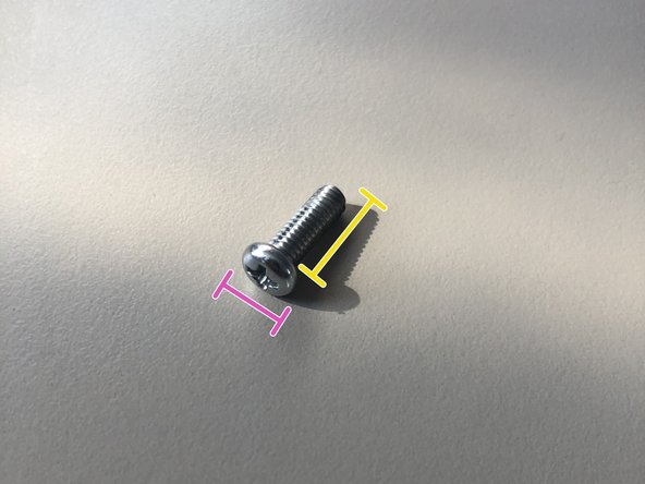

    • I first tried unscrewing 4 screws (M2 x 1mm Phillips Head Screw) from bottom of the base. Although one of the screws was quite stuck and would not unscrew, I moved on to saw through the seal with a multi tool.
    • Screw head diameter: 7mm
    • Screw shaft length: 12mm

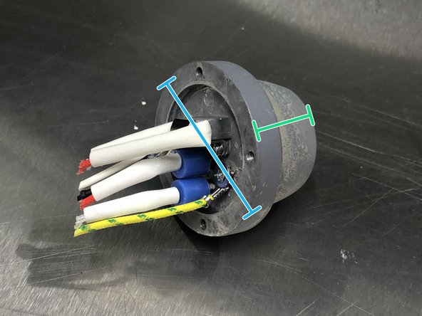

  11. Allersearch Hippo Deluxe Room Steam Vaporiser, Removing the main heating device: crwdns2935265:011crwdnd2935265:01crwdnd2935265:03crwdne2935265:0 Allersearch Hippo Deluxe Room Steam Vaporiser, Removing the main heating device: crwdns2935265:011crwdnd2935265:02crwdnd2935265:03crwdne2935265:0 Allersearch Hippo Deluxe Room Steam Vaporiser, Removing the main heating device: crwdns2935265:011crwdnd2935265:03crwdnd2935265:03crwdne2935265:0
    • The heating device was screwed in with 4, M3 x 0.5mm Phillips Head Screw. This was situated on top of the heating cone, underneath the steam chamber.
    • This the rim of the base that grips the heating elements in its place. It also helps keep the element relatively clean.
    • Rim Outer Diameter: 64mm
    • Rim Inner Diameter: 50mm
    • Length/diameter of the base: 57mm
    • Height: 46mm
