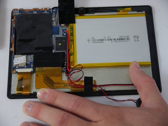

    1. Alldaymall A88X Touch Sensor Replacement, Speaker: crwdns2935265:03crwdnd2935265:01crwdnd2935265:03crwdne2935265:0 Alldaymall A88X Touch Sensor Replacement, Speaker: crwdns2935265:03crwdnd2935265:02crwdnd2935265:03crwdne2935265:0 Alldaymall A88X Touch Sensor Replacement, Speaker: crwdns2935265:03crwdnd2935265:03crwdnd2935265:03crwdne2935265:0

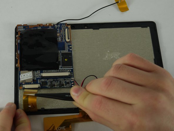

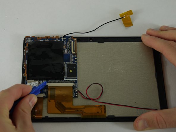

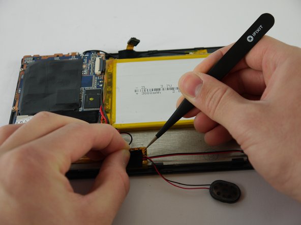

      • Carefully separate the speaker wire from the tape and proceed to peel the tape off in an upwards direction.
      • The tape we are removing covers a number of connections on the motherboard. Be extra careful not to sever any of these.
    2. Alldaymall A88X Touch Sensor Replacement: crwdns2935265:04crwdnd2935265:01crwdnd2935265:03crwdne2935265:0 Alldaymall A88X Touch Sensor Replacement: crwdns2935265:04crwdnd2935265:02crwdnd2935265:03crwdne2935265:0 Alldaymall A88X Touch Sensor Replacement: crwdns2935265:04crwdnd2935265:03crwdnd2935265:03crwdne2935265:0

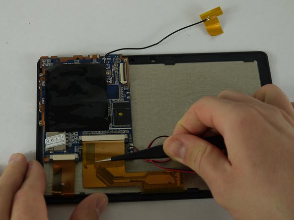

      • Using a pair of tweezers, begin separating the tape downwards from the back panel.
      • Pull the tape away from the wire bundle beneath.
      • Isolate the wire running from the speaker to the motherboard.

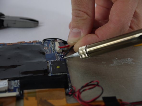

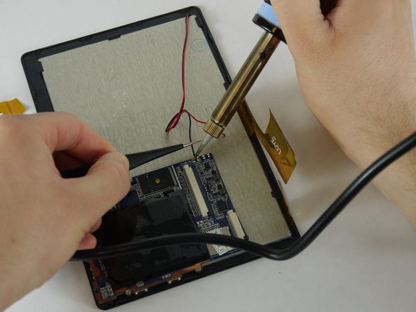

    3. Alldaymall A88X Touch Sensor Replacement: crwdns2935265:05crwdnd2935265:01crwdnd2935265:03crwdne2935265:0 Alldaymall A88X Touch Sensor Replacement: crwdns2935265:05crwdnd2935265:02crwdnd2935265:03crwdne2935265:0 Alldaymall A88X Touch Sensor Replacement: crwdns2935265:05crwdnd2935265:03crwdnd2935265:03crwdne2935265:0
      • Desolder the speaker wires from the motherboard.

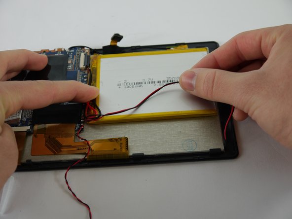

    1. Alldaymall A88X Touch Sensor Replacement, Camera: crwdns2935265:06crwdnd2935265:01crwdnd2935265:03crwdne2935265:0 Alldaymall A88X Touch Sensor Replacement, Camera: crwdns2935265:06crwdnd2935265:02crwdnd2935265:03crwdne2935265:0 Alldaymall A88X Touch Sensor Replacement, Camera: crwdns2935265:06crwdnd2935265:03crwdnd2935265:03crwdne2935265:0

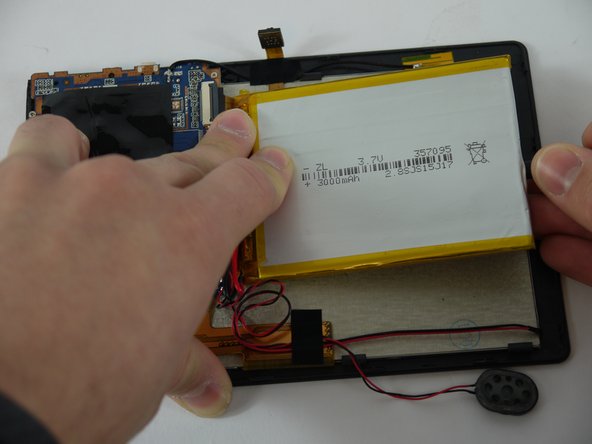

      • Using a nylon spudger, slowly work your way underneath the battery separating it from the panel beneath.
      • After the battery is separated from the panel make sure to place it face down above the tablet itself.
      • Throughout the removal process keep an eye on the battery's wires and make sure they do not break.

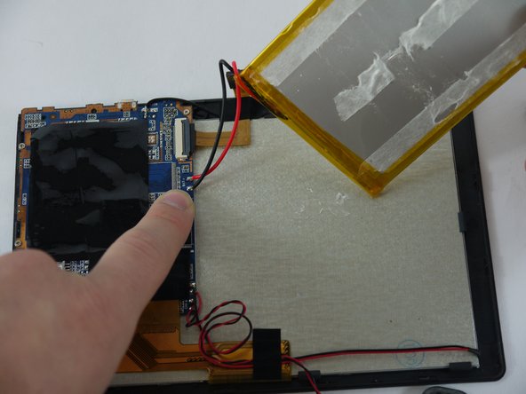

    2. Alldaymall A88X Touch Sensor Replacement: crwdns2935265:07crwdnd2935265:01crwdnd2935265:02crwdne2935265:0 Alldaymall A88X Touch Sensor Replacement: crwdns2935265:07crwdnd2935265:02crwdnd2935265:02crwdne2935265:0

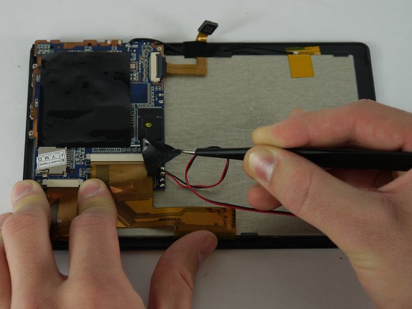

      • Desolder the wires that connect the battery to the motherboard.
    3. Alldaymall A88X Touch Sensor Replacement: crwdns2935265:08crwdnd2935265:01crwdnd2935265:02crwdne2935265:0 Alldaymall A88X Touch Sensor Replacement: crwdns2935265:08crwdnd2935265:02crwdnd2935265:02crwdne2935265:0
      • Using a pair of tweezers begin to peel the tape covering the ribbon cable on the motherboard.

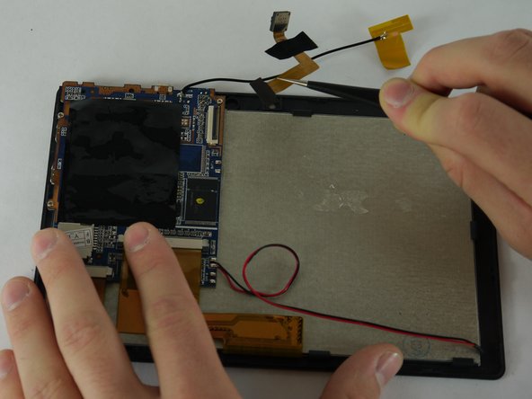

      • Using a pair of tweezers begin to peel the antenna from the metal panel.
      • Work your way down until the antenna is completely removed.
      • Be careful not deform the antenna or sever its connection.
    5. Alldaymall A88X Touch Sensor Replacement: crwdns2935265:010crwdnd2935265:01crwdnd2935265:01crwdne2935265:0
      • Using a pair of tweezers remove the tape securing the cameras to the back panel.
    6. Alldaymall A88X Touch Sensor Replacement: crwdns2935265:011crwdnd2935265:01crwdnd2935265:01crwdne2935265:0

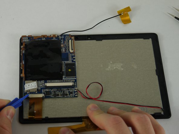

      • Using a plastic opening tool lift up the flap on the ribbon cable receptacle.
    7. Alldaymall A88X Touch Sensor Replacement: crwdns2935265:012crwdnd2935265:01crwdnd2935265:02crwdne2935265:0 Alldaymall A88X Touch Sensor Replacement: crwdns2935265:012crwdnd2935265:02crwdnd2935265:02crwdne2935265:0

      • Use a plastic opening tool to pull out the black knobs on both sides of the ribbon cable receptacle.
      • Using a pair of tweezers remove the ribbon cable from its receptacle.
    2. Alldaymall A88X Touch Sensor Replacement: crwdns2935265:014crwdnd2935265:01crwdnd2935265:03crwdne2935265:0 Alldaymall A88X Touch Sensor Replacement: crwdns2935265:014crwdnd2935265:02crwdnd2935265:03crwdne2935265:0 Alldaymall A88X Touch Sensor Replacement: crwdns2935265:014crwdnd2935265:03crwdnd2935265:03crwdne2935265:0
      • Now on the left ribbon cable use a plastic opening tool to pull out the black knobs on both sides of the ribbon cable receptacle.

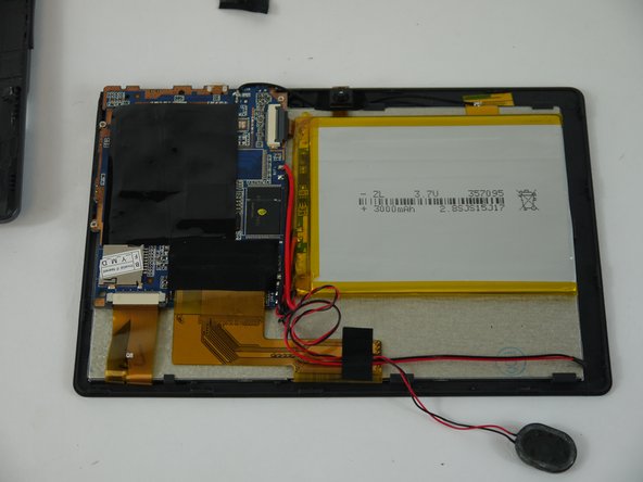

      • Desolder the wires that connect the backlight to the motherboard.

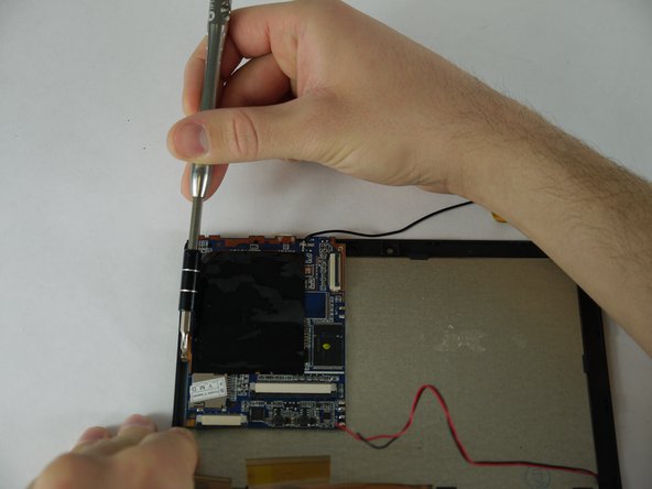

    4. Alldaymall A88X Touch Sensor Replacement: crwdns2935265:016crwdnd2935265:01crwdnd2935265:03crwdne2935265:0 Alldaymall A88X Touch Sensor Replacement: crwdns2935265:016crwdnd2935265:02crwdnd2935265:03crwdne2935265:0 Alldaymall A88X Touch Sensor Replacement: crwdns2935265:016crwdnd2935265:03crwdnd2935265:03crwdne2935265:0

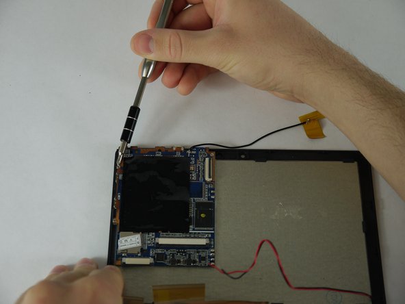

      • Using a PH0 screw bit unscrew the three 3mm screws securing the motherboard to the back panel.
    5. Alldaymall A88X Touch Sensor Replacement: crwdns2935265:017crwdnd2935265:01crwdnd2935265:01crwdne2935265:0
      • Carefully lift up on the motherboard from its housing.

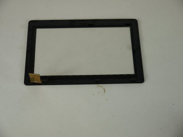

    1. Alldaymall A88X Touch Sensor Replacement, LCD Screen and Touch Sensor Assembly: crwdns2935265:018crwdnd2935265:01crwdnd2935265:03crwdne2935265:0 Alldaymall A88X Touch Sensor Replacement, LCD Screen and Touch Sensor Assembly: crwdns2935265:018crwdnd2935265:02crwdnd2935265:03crwdne2935265:0 Alldaymall A88X Touch Sensor Replacement, LCD Screen and Touch Sensor Assembly: crwdns2935265:018crwdnd2935265:03crwdnd2935265:03crwdne2935265:0
      • Gently pry the brackets holding the touch sensor to the LCD Screen
      • Do not bend the touch sensor to much as it may shatter.
    1. Alldaymall A88X Touch Sensor Replacement, Touch Sensor: crwdns2935265:019crwdnd2935265:01crwdnd2935265:02crwdne2935265:0 Alldaymall A88X Touch Sensor Replacement, Touch Sensor: crwdns2935265:019crwdnd2935265:02crwdnd2935265:02crwdne2935265:0
      • Set the LCD Screen aside.
