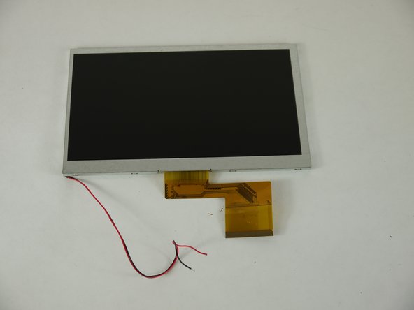

    1. Alldaymall A88X LCD Screen Replacement, LCD Screen and Touch Sensor Assembly: crwdns2935265:018crwdnd2935265:01crwdnd2935265:03crwdne2935265:0 Alldaymall A88X LCD Screen Replacement, LCD Screen and Touch Sensor Assembly: crwdns2935265:018crwdnd2935265:02crwdnd2935265:03crwdne2935265:0 Alldaymall A88X LCD Screen Replacement, LCD Screen and Touch Sensor Assembly: crwdns2935265:018crwdnd2935265:03crwdnd2935265:03crwdne2935265:0
      • Gently pry the brackets holding the touch sensor to the LCD Screen
      • Do not bend the touch sensor to much as it may shatter.
    1. Alldaymall A88X LCD Screen Replacement, LCD Screen: crwdns2935265:019crwdnd2935265:01crwdnd2935265:02crwdne2935265:0 Alldaymall A88X LCD Screen Replacement, LCD Screen: crwdns2935265:019crwdnd2935265:02crwdnd2935265:02crwdne2935265:0
      • Set the touch sensor aside.
