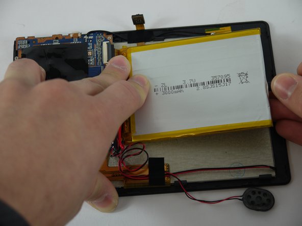

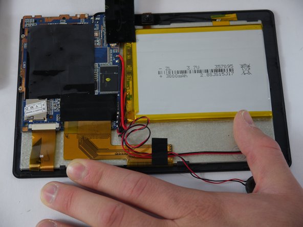

  3. Alldaymall A88X Battery Replacement, Battery: crwdns2935265:03crwdnd2935265:01crwdnd2935265:03crwdne2935265:0 Alldaymall A88X Battery Replacement, Battery: crwdns2935265:03crwdnd2935265:02crwdnd2935265:03crwdne2935265:0 Alldaymall A88X Battery Replacement, Battery: crwdns2935265:03crwdnd2935265:03crwdnd2935265:03crwdne2935265:0
    • Carefully separate the speaker wire from the tape and proceed to peel the tape off in an upwards direction.
    • The tape we are removing covers a number of connections on the motherboard. Be extra careful not to server any of these.

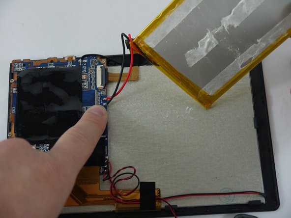

  4. Alldaymall A88X Battery Replacement: crwdns2935265:04crwdnd2935265:01crwdnd2935265:03crwdne2935265:0 Alldaymall A88X Battery Replacement: crwdns2935265:04crwdnd2935265:02crwdnd2935265:03crwdne2935265:0 Alldaymall A88X Battery Replacement: crwdns2935265:04crwdnd2935265:03crwdnd2935265:03crwdne2935265:0
    • Using a nylon spudger, slowly work your way underneath the battery separating it from the panel beneath.
    • After the battery is separated from the panel make sure to place it face down above the tablet itself.
    • Throughout the removal process keep an eye on the battery's wires and make sure they do not break.

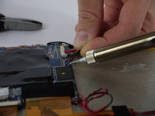

  5. Alldaymall A88X Battery Replacement: crwdns2935265:05crwdnd2935265:01crwdnd2935265:02crwdne2935265:0 Alldaymall A88X Battery Replacement: crwdns2935265:05crwdnd2935265:02crwdnd2935265:02crwdne2935265:0
    • Desolder the wires that connect the battery to the motherboard.
