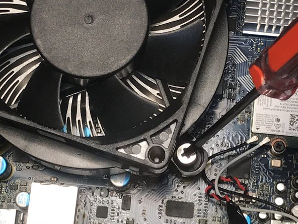

  4. Alienware x51 r3 CPU Fan Replacement: crwdns2935265:04crwdnd2935265:01crwdnd2935265:02crwdne2935265:0 Alienware x51 r3 CPU Fan Replacement: crwdns2935265:04crwdnd2935265:02crwdnd2935265:02crwdne2935265:0
    • Using a #0 Phillips screwdriver, remove the screws connecting the fan to the motherboard by rotating the screwdriver counter-clockwise.
    • To prevent bending, try to unscrew each corner a little bit at a time, rather than unscrewing one side completely before moving onto the next.

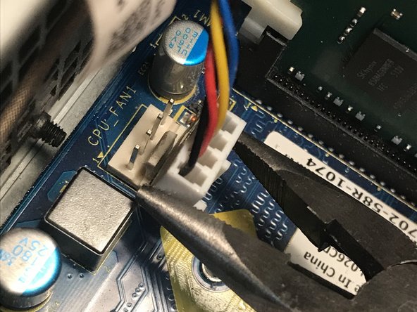

  5. Alienware x51 r3 CPU Fan Replacement: crwdns2935265:05crwdnd2935265:01crwdnd2935265:03crwdne2935265:0 Alienware x51 r3 CPU Fan Replacement: crwdns2935265:05crwdnd2935265:02crwdnd2935265:03crwdne2935265:0 Alienware x51 r3 CPU Fan Replacement: crwdns2935265:05crwdnd2935265:03crwdnd2935265:03crwdne2935265:0
    • Using either your hands or a small needle nose plier, carefully remove cable connecting the fan to the desktop.
    • Do not rip the cable straight out. Instead, try wiggling the plier back and forth to disconnect.

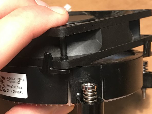

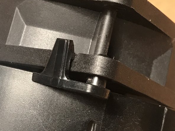

  6. Alienware x51 r3 CPU Fan Replacement: crwdns2935265:06crwdnd2935265:01crwdnd2935265:03crwdne2935265:0 Alienware x51 r3 CPU Fan Replacement: crwdns2935265:06crwdnd2935265:02crwdnd2935265:03crwdne2935265:0 Alienware x51 r3 CPU Fan Replacement: crwdns2935265:06crwdnd2935265:03crwdnd2935265:03crwdne2935265:0
    • Using your thumb and forefinger, pry off the four clips holding the fan to the heatsink.

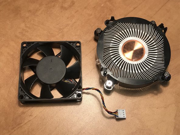

  7. Alienware x51 r3 CPU Fan Replacement: crwdns2935265:07crwdnd2935265:01crwdnd2935265:02crwdne2935265:0 Alienware x51 r3 CPU Fan Replacement: crwdns2935265:07crwdnd2935265:02crwdnd2935265:02crwdne2935265:0
    • Place the new or cleaned fan onto the heatsink, and press down on the corners to lock the fan onto the heatsink.
    • Make sure that the fan is positioned to blow air into the heatsink, rather than out.
