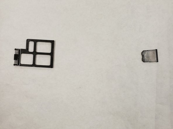

    • Flip the laptop over and slide the battery release latch to the right.
  2. Alienware M18x CD Drive Replacement: crwdns2935265:02crwdnd2935265:01crwdnd2935265:02crwdne2935265:0 Alienware M18x CD Drive Replacement: crwdns2935265:02crwdnd2935265:02crwdnd2935265:02crwdne2935265:0
    • Remove battery.

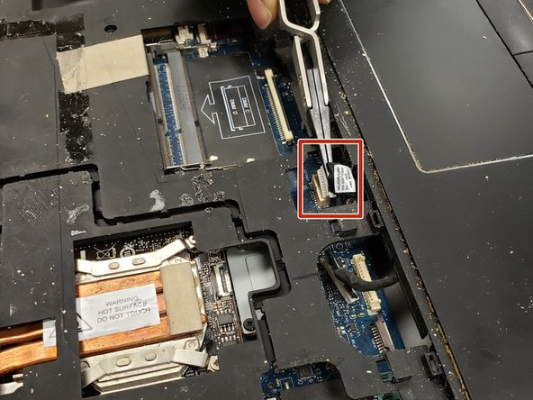

    • Locate and remove the first connector cable.
    • Use a prying tool to assist in unplugging the cable.

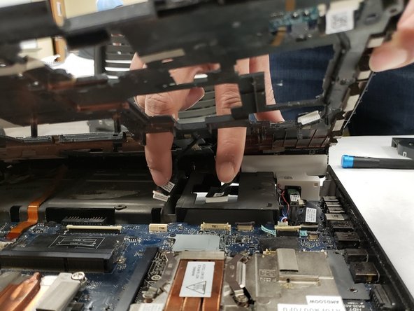

    • Computer should be upright.
    • Find the connecting tab that is holding the laptop's top section in place.
    • Disconnect the tab with needle-nose pliers.
    • Lift the panel up slowly to gain access to the internal parts.

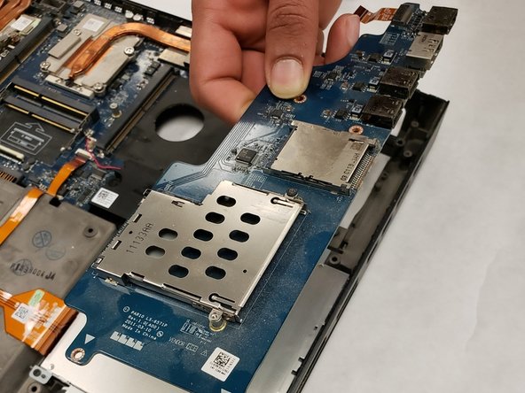

    • Track down the blue USB board. The CD Drive is covered by this board.
    • Locate the card holders' edges, and then gently pry each one from its socket
  18. Alienware M18x CD Drive Replacement: crwdns2935265:018crwdnd2935265:01crwdnd2935265:03crwdne2935265:0 Alienware M18x CD Drive Replacement: crwdns2935265:018crwdnd2935265:02crwdnd2935265:03crwdne2935265:0 Alienware M18x CD Drive Replacement: crwdns2935265:018crwdnd2935265:03crwdnd2935265:03crwdne2935265:0

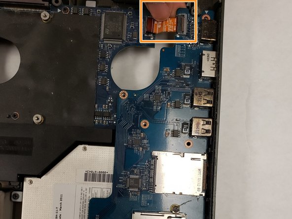

    • With a screwdriver, remove the screws holding the USB port board in place.
    • To remove all connections from the board, disconnect the orange tab.
    • In order to access the CD Drive, raise the board.

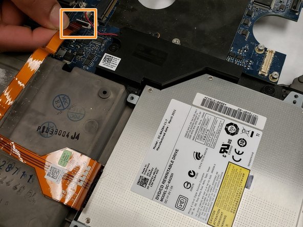

    • The CD Drive housing should be free of the four 3mm screws.
    • The orange connector's thin end should be disconnected from the motherboard. The CD Drive should still be attached to one end of it.
    • From the laptop, gently remove the CD drive.
