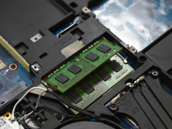

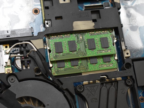

    1. Alienware M17x RAM Replacement, RAM: crwdns2935265:05crwdnd2935265:01crwdnd2935265:02crwdne2935265:0 Alienware M17x RAM Replacement, RAM: crwdns2935265:05crwdnd2935265:02crwdnd2935265:02crwdne2935265:0
      • With the laptop flipped over, cover removed, and battery removed; continue by locating your RAM cards.
    2. Alienware M17x RAM Replacement: crwdns2935265:06crwdnd2935265:01crwdnd2935265:02crwdne2935265:0 Alienware M17x RAM Replacement: crwdns2935265:06crwdnd2935265:02crwdnd2935265:02crwdne2935265:0
      • Remove the top RAM card by pressing the tabs to the sides using the Plastic Opening Tool.
      • Once the top card has popped up, carefully remove it by holding the sides and sliding it out.
    3. Alienware M17x RAM Replacement: crwdns2935265:07crwdnd2935265:01crwdnd2935265:01crwdne2935265:0
      • Remove the bottom RAM card in a similar manner.

The only problem is that this laptop has 4 slots of ram there are 2 more under the keyboard that must also be accessed to update. If anyone wants to know how I know it’s because I have this laptop and I have seen where the next lot of ram is located
