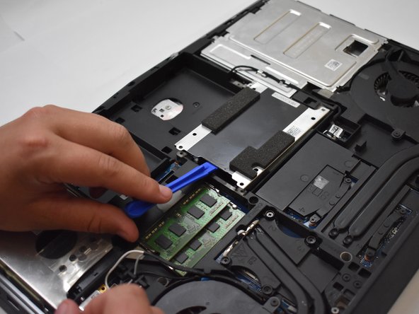

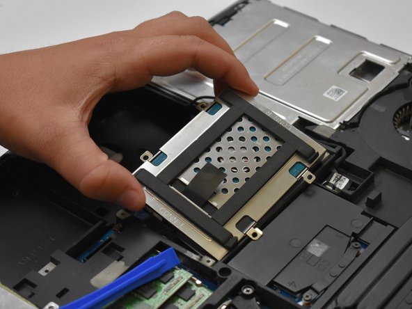

  5. Alienware M17x Hard Drive Replacement, Hard Drive: crwdns2935265:05crwdnd2935265:01crwdnd2935265:01crwdne2935265:0
    • With the laptop flipped over, cover removed, and battery removed; continue by locating your hard drive(s).
  6. Alienware M17x Hard Drive Replacement: crwdns2935265:06crwdnd2935265:01crwdnd2935265:03crwdne2935265:0 Alienware M17x Hard Drive Replacement: crwdns2935265:06crwdnd2935265:02crwdnd2935265:03crwdne2935265:0 Alienware M17x Hard Drive Replacement: crwdns2935265:06crwdnd2935265:03crwdnd2935265:03crwdne2935265:0
    • Remove the eight 3.5 mm Phillips #0 screws.
    • Remove the hard drive(s), using the Plastic Opening Tool by lifting on the edges and pulling the hard drive up and out.
