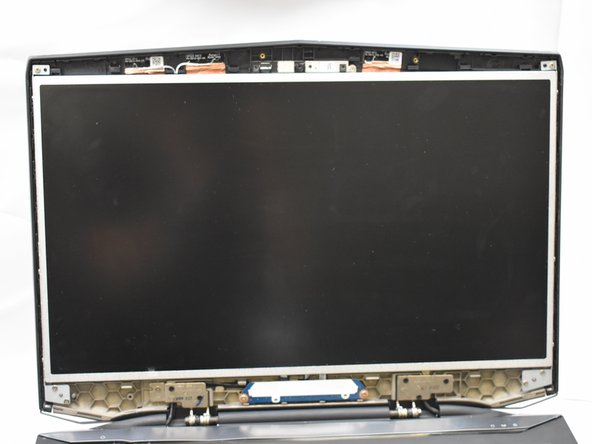

    1. Alienware M17x Display Assembly Replacement, Display Assembly: crwdns2935265:05crwdnd2935265:01crwdnd2935265:01crwdne2935265:0
      • Flip the laptop back over so that the Alienware logo faces the ceiling then open the lid to view the screen.

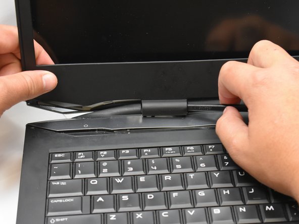

    2. Alienware M17x Display Assembly Replacement: crwdns2935265:06crwdnd2935265:01crwdnd2935265:03crwdne2935265:0 Alienware M17x Display Assembly Replacement: crwdns2935265:06crwdnd2935265:02crwdnd2935265:03crwdne2935265:0 Alienware M17x Display Assembly Replacement: crwdns2935265:06crwdnd2935265:03crwdnd2935265:03crwdne2935265:0
      • Use a spudger as a lever to pry the black plastic siding off of the frame starting on either of the top corners.
      • Use the spudger to remove the siding from the bottom of the frame near the hinges.
      • Carefully lift the black plastic siding up and out of the hinged area making sure not to break the fragile sides.

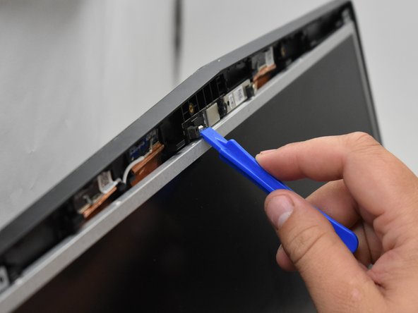

    3. Alienware M17x Display Assembly Replacement: crwdns2935265:07crwdnd2935265:01crwdnd2935265:02crwdne2935265:0 Alienware M17x Display Assembly Replacement: crwdns2935265:07crwdnd2935265:02crwdnd2935265:02crwdne2935265:0
      • Use the plastic opening tool to disconnect the screen from the top mount.
    4. Alienware M17x Display Assembly Replacement: crwdns2935265:08crwdnd2935265:01crwdnd2935265:01crwdne2935265:0
      • Avoid directly touching the connectors with anything other than plastic tools to avoid damaging the internal components.
    5. Alienware M17x Display Assembly Replacement: crwdns2935265:09crwdnd2935265:01crwdnd2935265:01crwdne2935265:0
      • Tilt the screen forward to expose the connecting wires.
      • Disconnect said wires to then lift the display assembly out of the frame.
