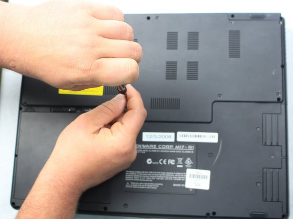

    1. Alienware M17-R1 RAM Replacement, RAM: crwdns2935265:03crwdnd2935265:01crwdnd2935265:01crwdne2935265:0
      • Place laptop down on a hard flat surface to begin the disassembly.
    2. Alienware M17-R1 RAM Replacement: crwdns2935265:04crwdnd2935265:01crwdnd2935265:02crwdne2935265:0 Alienware M17-R1 RAM Replacement: crwdns2935265:04crwdnd2935265:02crwdnd2935265:02crwdne2935265:0
      • Remove the nine 3 mm screws that secure the cover using a Phillips #1 screwdriver.
    3. Alienware M17-R1 RAM Replacement: crwdns2935265:05crwdnd2935265:01crwdnd2935265:01crwdne2935265:0
      • Once the cover is removed, locate the RAM compartment to begin the replacement.
    4. Alienware M17-R1 RAM Replacement: crwdns2935265:06crwdnd2935265:01crwdnd2935265:02crwdne2935265:0 Alienware M17-R1 RAM Replacement: crwdns2935265:06crwdnd2935265:02crwdnd2935265:02crwdne2935265:0
      • After locating the RAM, gently pull the two metal clips outward and lift the RAM card out of its socket.
      • The card will pop up once it has been released and can be removed.
    5. Alienware M17-R1 RAM Replacement: crwdns2935265:07crwdnd2935265:01crwdnd2935265:01crwdne2935265:0
      • To insert the new RAM, place it on top of the socket and carefully apply downward pressure until it snaps into place.
