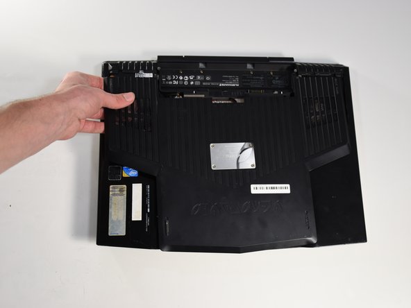

    1. Alienware M15x RAM Replacement, Battery: crwdns2935265:01crwdnd2935265:01crwdnd2935265:03crwdne2935265:0 Alienware M15x RAM Replacement, Battery: crwdns2935265:01crwdnd2935265:02crwdnd2935265:03crwdne2935265:0 Alienware M15x RAM Replacement, Battery: crwdns2935265:01crwdnd2935265:03crwdnd2935265:03crwdne2935265:0
      • Remove the battery by sliding the latch to the left and pulling the battery up.
    1. Alienware M15x RAM Replacement, Compartment Door: crwdns2935265:02crwdnd2935265:01crwdnd2935265:02crwdne2935265:0 Alienware M15x RAM Replacement, Compartment Door: crwdns2935265:02crwdnd2935265:02crwdnd2935265:02crwdne2935265:0
      • Remove the two 4-mm screws that hold the compartment door to the rest of the computer using a PH#0 screwdriver tip.

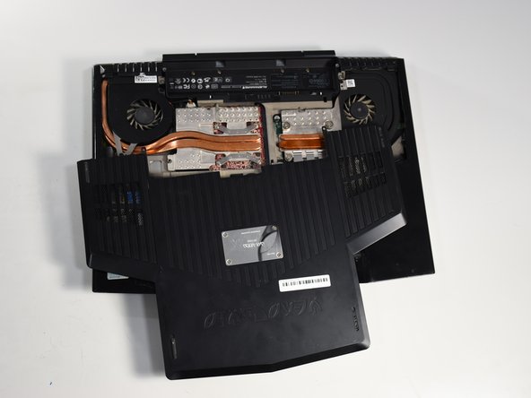

    2. Alienware M15x RAM Replacement: crwdns2935265:03crwdnd2935265:01crwdnd2935265:03crwdne2935265:0 Alienware M15x RAM Replacement: crwdns2935265:03crwdnd2935265:02crwdnd2935265:03crwdne2935265:0 Alienware M15x RAM Replacement: crwdns2935265:03crwdnd2935265:03crwdnd2935265:03crwdne2935265:0
      • Slide the compartment door towards the front of the computer and lift.
