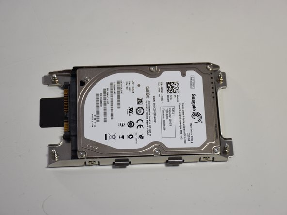

  5. Alienware M15x Hard Drive Replacement: crwdns2935265:05crwdnd2935265:01crwdnd2935265:02crwdne2935265:0 Alienware M15x Hard Drive Replacement: crwdns2935265:05crwdnd2935265:02crwdnd2935265:02crwdne2935265:0
    • Once the screws are loosened use the "PULL" tab to remove the current hard drive from the computer.

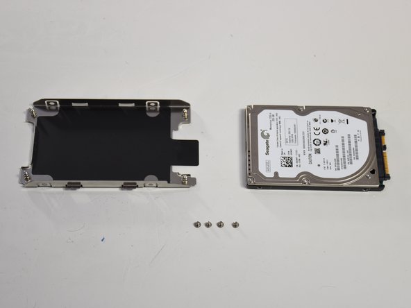

  6. Alienware M15x Hard Drive Replacement: crwdns2935265:06crwdnd2935265:01crwdnd2935265:02crwdne2935265:0 Alienware M15x Hard Drive Replacement: crwdns2935265:06crwdnd2935265:02crwdnd2935265:02crwdne2935265:0
    • Remove the four small screws indicated to remove the casing to the hard drive.
  7. Alienware M15x Hard Drive Replacement: crwdns2935265:07crwdnd2935265:01crwdnd2935265:01crwdne2935265:0
    • Now take off the SATA converter and then connect it to the drive you would like to replace it with.
