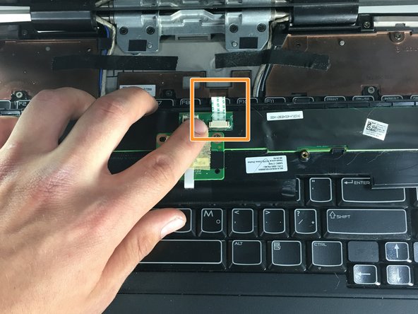

      • Position the laptop normally, with the bottom on the ground and the screen flipped up towards you.
      • Lift the power button panel using the plastic opening tool.
      • Disconnect the ribbon cable by using tweezers to unclip the two small black clips. Remove power button panel.

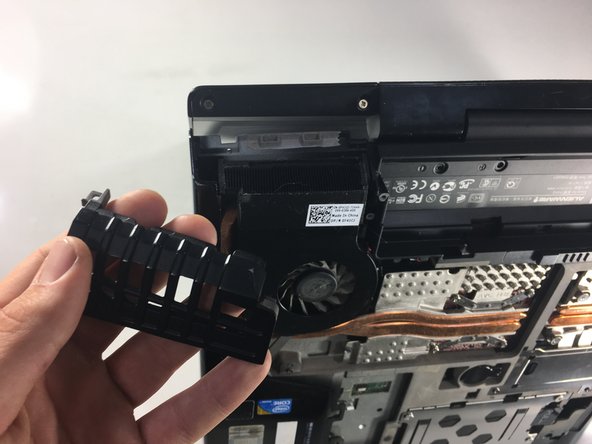

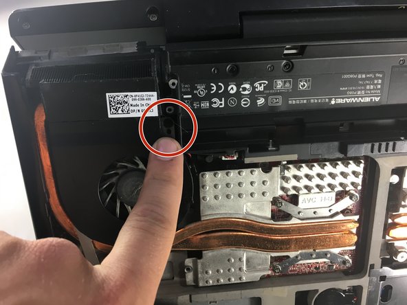

    8. Alienware M15x GPU Replacement: crwdns2935265:08crwdnd2935265:01crwdnd2935265:02crwdne2935265:0 Alienware M15x GPU Replacement: crwdns2935265:08crwdnd2935265:02crwdnd2935265:02crwdne2935265:0
      • Use a Phillips #1 screwdriver to remove the 4mm screw from the exhaust port cover.
      • Remove the exhaust port cover entirely.

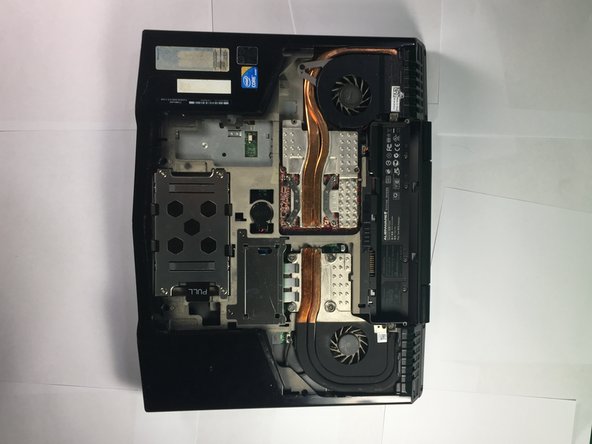

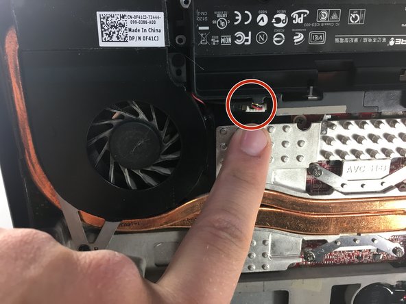

      • Use a Phillips #0 screwdriver to remove the two 3mm screws holding the fan in place, then unclip the electrical connection using tweezers.
    10. Alienware M15x GPU Replacement: crwdns2935265:010crwdnd2935265:01crwdnd2935265:01crwdne2935265:0
      • Remove the heat sink by loosening the 4 screws with a Phillips #0 screwdriver.
