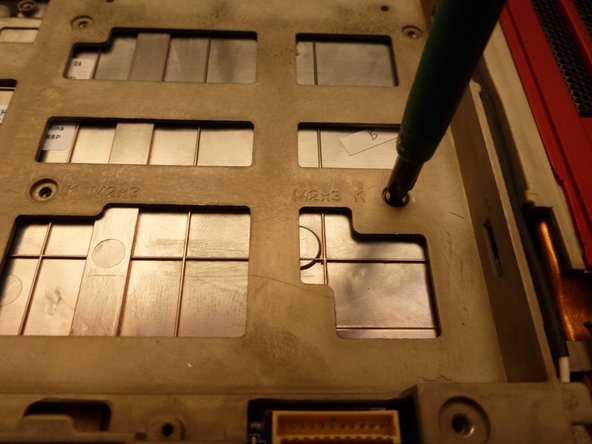

  10. Alienware M11xR3 Disassembly and Cleaning, Remove chassis and keyboard screws: crwdns2935265:010crwdnd2935265:01crwdnd2935265:03crwdne2935265:0 Alienware M11xR3 Disassembly and Cleaning, Remove chassis and keyboard screws: crwdns2935265:010crwdnd2935265:02crwdnd2935265:03crwdne2935265:0 Alienware M11xR3 Disassembly and Cleaning, Remove chassis and keyboard screws: crwdns2935265:010crwdnd2935265:03crwdnd2935265:03crwdne2935265:0
    • Remove the chassis screws using a Phillips #1 screwdriver.
    • Remove the keyboard screws using a Phillips #1 screwdriver.
  11. Alienware M11xR3 Disassembly and Cleaning, Remove the chassis screws: crwdns2935265:011crwdnd2935265:01crwdnd2935265:03crwdne2935265:0 Alienware M11xR3 Disassembly and Cleaning, Remove the chassis screws: crwdns2935265:011crwdnd2935265:02crwdnd2935265:03crwdne2935265:0 Alienware M11xR3 Disassembly and Cleaning, Remove the chassis screws: crwdns2935265:011crwdnd2935265:03crwdnd2935265:03crwdne2935265:0
    • Remove the chassis screws.

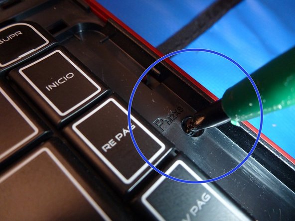

  14. Alienware M11xR3 Disassembly and Cleaning, Remove the screws from the keyboard: crwdns2935265:014crwdnd2935265:01crwdnd2935265:02crwdne2935265:0 Alienware M11xR3 Disassembly and Cleaning, Remove the screws from the keyboard: crwdns2935265:014crwdnd2935265:02crwdnd2935265:02crwdne2935265:0
    • Remove the screws from the keyboard.

    • Remove the two screws to release the keyboard.
    • Wait for the next step to remove the keyboard; there are bus data cables underneath the keyboard that must be removed first.

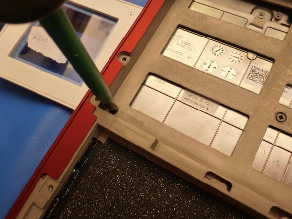

  20. Alienware M11xR3 Disassembly and Cleaning, Remove more chassis screws: crwdns2935265:020crwdnd2935265:01crwdnd2935265:03crwdne2935265:0 Alienware M11xR3 Disassembly and Cleaning, Remove more chassis screws: crwdns2935265:020crwdnd2935265:02crwdnd2935265:03crwdne2935265:0 Alienware M11xR3 Disassembly and Cleaning, Remove more chassis screws: crwdns2935265:020crwdnd2935265:03crwdnd2935265:03crwdne2935265:0
    • Continue taking out the chassis by unscrewing the 3 shown screws.
    • First one to the left of the RGB bus data cable.
    • Second one at bottom near the touchpad.
    • Third one on the right edge of the laptop.

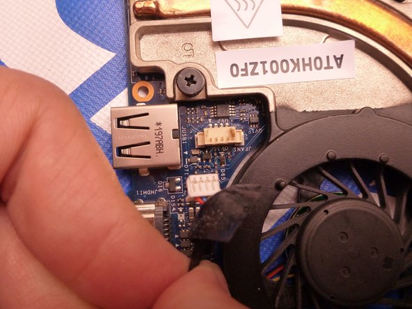

  33. Alienware M11xR3 Disassembly and Cleaning, Removing the motherboard.: crwdns2935265:033crwdnd2935265:01crwdnd2935265:03crwdne2935265:0 Alienware M11xR3 Disassembly and Cleaning, Removing the motherboard.: crwdns2935265:033crwdnd2935265:02crwdnd2935265:03crwdne2935265:0 Alienware M11xR3 Disassembly and Cleaning, Removing the motherboard.: crwdns2935265:033crwdnd2935265:03crwdnd2935265:03crwdne2935265:0
    • Remove the four screws, marked by red circles, to remove the motherboard.
    • Now lift the motherboard slowly up while moving it to the right. Removing it this way prevents damage to your ports.
    • As you see in the picture, the I/O board and screen connector wasn't here. They must be disconnected before removing the motherboard, not like the bluetooth board or coin-cell battery.

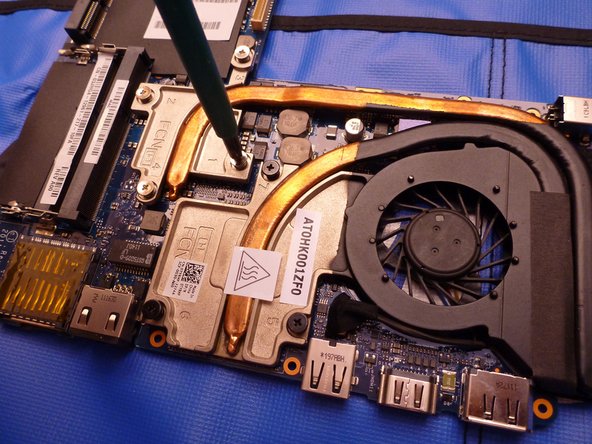

  35. Alienware M11xR3 Disassembly and Cleaning, Remove heat sink and apply thermal paste: crwdns2935265:035crwdnd2935265:01crwdnd2935265:03crwdne2935265:0 Alienware M11xR3 Disassembly and Cleaning, Remove heat sink and apply thermal paste: crwdns2935265:035crwdnd2935265:02crwdnd2935265:03crwdne2935265:0 Alienware M11xR3 Disassembly and Cleaning, Remove heat sink and apply thermal paste: crwdns2935265:035crwdnd2935265:03crwdnd2935265:03crwdne2935265:0
    • If this is your first time applying thermal paste, I recommend using a quality thermal paste brand like Arctic Silver and reading a guide here on iFixit.
    • With the motherboard out, turn it upside down on a static free surface.
    • To remove the heatsink and replace thermal paste, remove the screws in the correct order (marked with a number on the heatsink).
    • Clean old thermal paste with isopropyl alcohol. Ensure that after applying thermal paste it doesn't leak onto the motherboard (if it's on the green square, it's fine).
    • When putting the heat sink back on, try to have the screw holes align on your first try. This is to maintain an even spread of the thermal paste.
    • Rescrew in the correct order (refer to the numbers on the heat sink).
    • Tighten each screw one at a time to end up with good heat dissipation.
