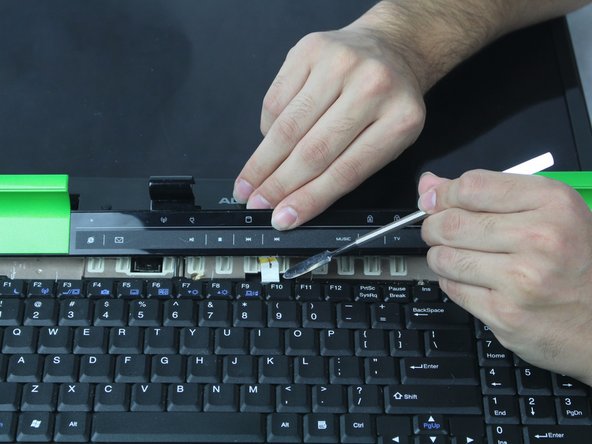

    • Open the laptop facing towards you.
    • On the right side where the power button is located, place the spudger to pry open the center panel as you slide it to the left.
    • Close the laptop and face the back portion towards you.
    • Between the green frame and the black panel insert the spudger to pry open the center panel. (Do this for both sides of the computer.)

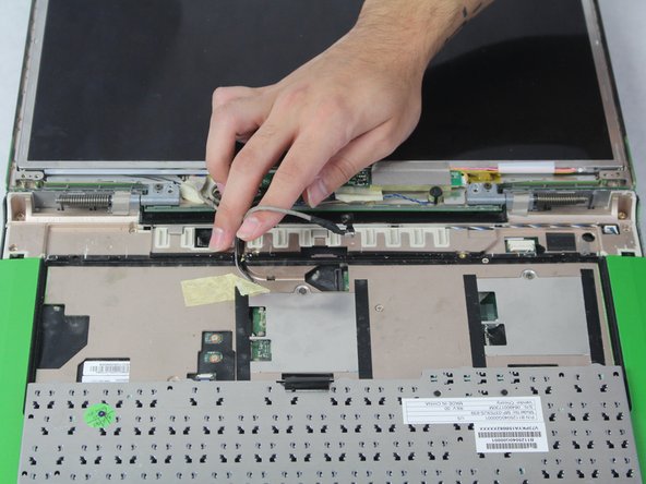

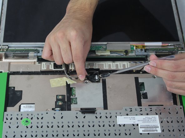

    • Now, open the computer and face it towards you.
    • Carefully, fold the panel towards you and disconnect the cable connected to the motherboard.

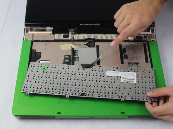

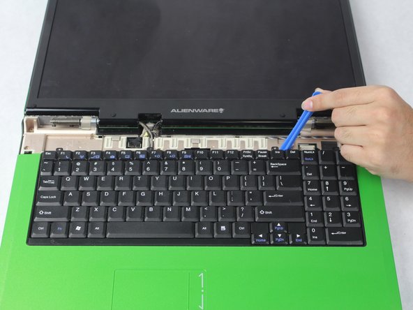

    • At the top of the keyboard, near the right corner, remove the screw that holds down the keyboard.
    • Insert a plastic opening tool and pry to lift up the keyboard.
    • Fold the keyboard towards you.

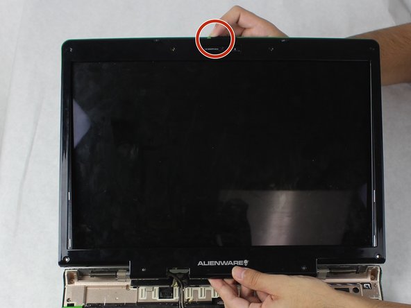

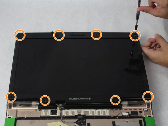

    • Locate the rubber buttons around the bezel of the display.
    • With the metal spudger remove them to expose the screws underneath.
    • Remove all of the 8 screws. Put them together. Those will be needed when putting a new screen back.

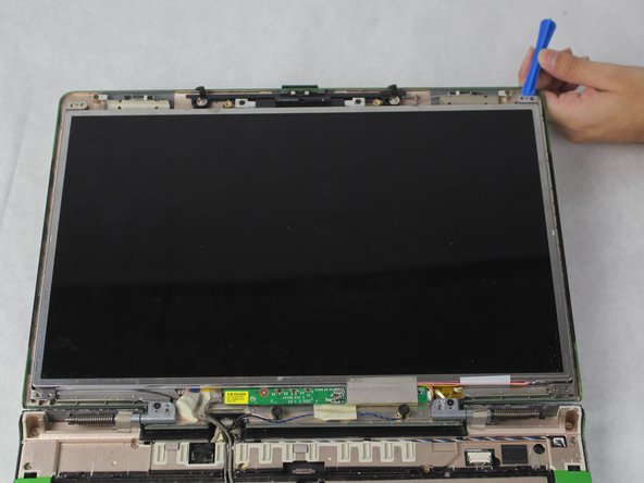

    • Locate and remove the 4 screws located on each corner of the display.
    • From the top of the display use the plastic opening tool to separate the screen display from the top of the laptop.

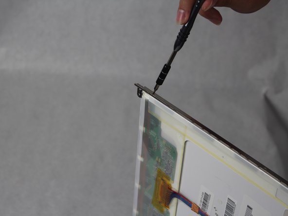

  9. Alienware Aurora M9700 Screen Replacement: crwdns2935265:09crwdnd2935265:01crwdnd2935265:03crwdne2935265:0 Alienware Aurora M9700 Screen Replacement: crwdns2935265:09crwdnd2935265:02crwdnd2935265:03crwdne2935265:0 Alienware Aurora M9700 Screen Replacement: crwdns2935265:09crwdnd2935265:03crwdnd2935265:03crwdne2935265:0

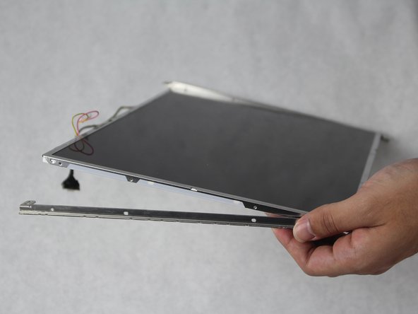

    • On the left of the display, remove the four screws located on the side of the display to remove the metal frame from the display. (Do the same for the right side.)
