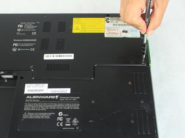

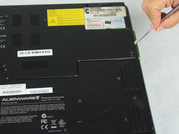

    • Located on the top right corner, find the 4 screws that are holding the back plate to the laptop.
    • Once the screws are removed insert the spudger on the right side and pry upwards to lift the plate to remove the plate.

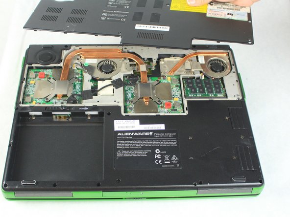

  4. Alienware Aurora M9700 RAM Replacement: crwdns2935265:04crwdnd2935265:01crwdnd2935265:03crwdne2935265:0 Alienware Aurora M9700 RAM Replacement: crwdns2935265:04crwdnd2935265:02crwdnd2935265:03crwdne2935265:0 Alienware Aurora M9700 RAM Replacement: crwdns2935265:04crwdnd2935265:03crwdnd2935265:03crwdne2935265:0

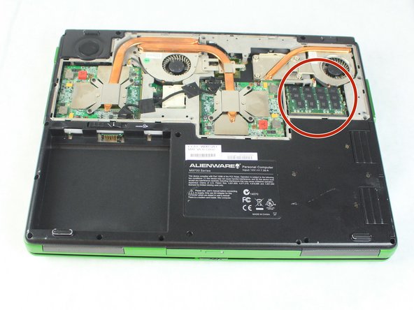

    • Lift the back plate of the laptop to expose the RAM.
    • Locate the RAM near the bottom edge of the top portion.

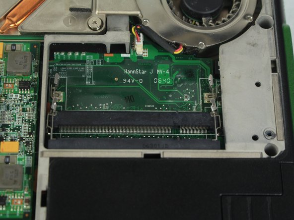

  5. Alienware Aurora M9700 RAM Replacement: crwdns2935265:05crwdnd2935265:01crwdnd2935265:03crwdne2935265:0 Alienware Aurora M9700 RAM Replacement: crwdns2935265:05crwdnd2935265:02crwdnd2935265:03crwdne2935265:0 Alienware Aurora M9700 RAM Replacement: crwdns2935265:05crwdnd2935265:03crwdnd2935265:03crwdne2935265:0

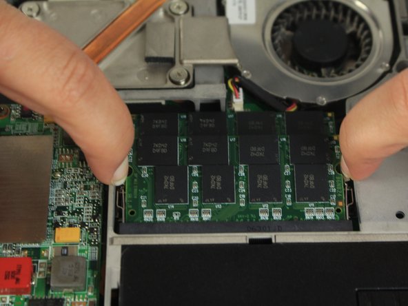

    • The RAM is secured by two aluminum locks on each side.

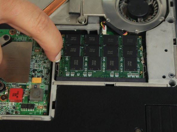

    • Pull the left-lock to the left to release the RAM.
    • While still holding the left hinge, pull the right-lock to the right and the RAM will be released.
  6. Alienware Aurora M9700 RAM Replacement: crwdns2935265:06crwdnd2935265:01crwdnd2935265:03crwdne2935265:0 Alienware Aurora M9700 RAM Replacement: crwdns2935265:06crwdnd2935265:02crwdnd2935265:03crwdne2935265:0 Alienware Aurora M9700 RAM Replacement: crwdns2935265:06crwdnd2935265:03crwdnd2935265:03crwdne2935265:0

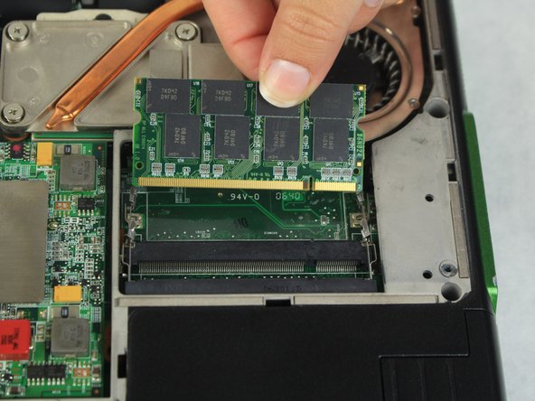

    • Once the RAM is released, pull the RAM out.
    • There may be a second RAM located below the first one, if so repeat step 5.
    • After both RAMS are removed you can now replace or upgrade the RAM.
