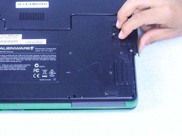

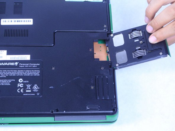

  3. Alienware Aurora M9700 Hard Drive Replacement: crwdns2935265:03crwdnd2935265:01crwdnd2935265:03crwdne2935265:0 Alienware Aurora M9700 Hard Drive Replacement: crwdns2935265:03crwdnd2935265:02crwdnd2935265:03crwdne2935265:0 Alienware Aurora M9700 Hard Drive Replacement: crwdns2935265:03crwdnd2935265:03crwdnd2935265:03crwdne2935265:0
    • At the bottom right corner, locate the two hard drives labeled 1 and 2.
    • Remove the screws located on top of the hard drives slots.
    • Once screws are removed from each hard drive, slide both hard drives out of the slot.

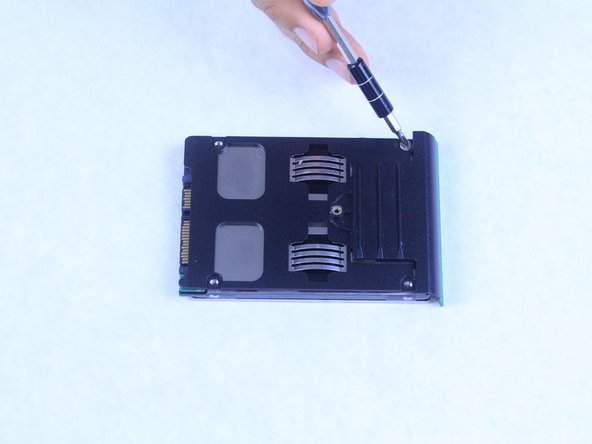

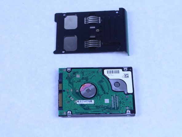

  4. Alienware Aurora M9700 Hard Drive Replacement: crwdns2935265:04crwdnd2935265:01crwdnd2935265:03crwdne2935265:0 Alienware Aurora M9700 Hard Drive Replacement: crwdns2935265:04crwdnd2935265:02crwdnd2935265:03crwdne2935265:0 Alienware Aurora M9700 Hard Drive Replacement: crwdns2935265:04crwdnd2935265:03crwdnd2935265:03crwdne2935265:0
    • Each hard drive is attached to a cover which contains 4 screws located on all 4 corners of the hard drive.
    • Remove each of the 4 screws on both hard drive covers.
    • Once both covers are removed only the original hard drive will remain.

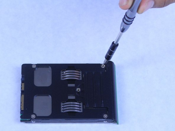

  5. Alienware Aurora M9700 Hard Drive Replacement: crwdns2935265:05crwdnd2935265:01crwdnd2935265:03crwdne2935265:0 Alienware Aurora M9700 Hard Drive Replacement: crwdns2935265:05crwdnd2935265:02crwdnd2935265:03crwdne2935265:0 Alienware Aurora M9700 Hard Drive Replacement: crwdns2935265:05crwdnd2935265:03crwdnd2935265:03crwdne2935265:0
    • Secure the new hard drive to the original hard drive cover, insert the screws on all 4 corners of the hard drive cover.
    • Complete this process for both hard drives. (Optional: if installing two drives.)
