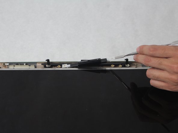

    • Now that the outer frame is removed, locate the two screws to the right and the left of the camera.
    • Remove the two screws freeing the camera of the brackets holding it in place.
    • Pry the camera upward from its designated location using the metal spudger.

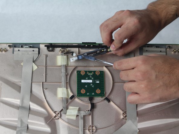

  4. Alienware Aurora M9700 Camera Replacement: crwdns2935265:04crwdnd2935265:01crwdnd2935265:02crwdne2935265:0 Alienware Aurora M9700 Camera Replacement: crwdns2935265:04crwdnd2935265:02crwdnd2935265:02crwdne2935265:0
    • Unplug the wire connection between the camera and the laptop.
