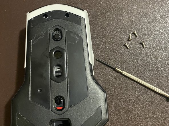

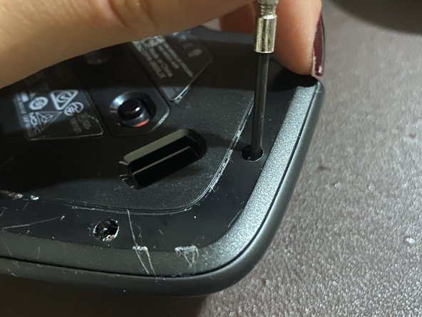

      • Use your Phillips #00 screwdriver to remove four 3.1 screws from the mouse.

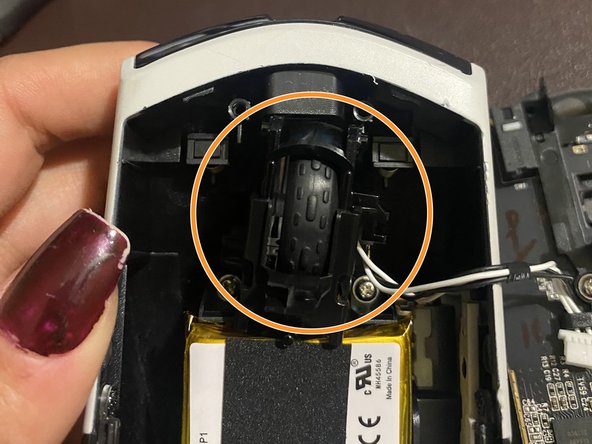

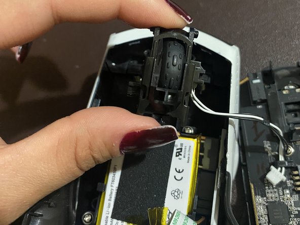

      • Locate the scroll wheel placed in the gap of the mouse's backing.
      • My scroll wheel was crooked, most likely causing my issue.
      • Gently lift the scroll wheel mechanism out of the mouse's backing.

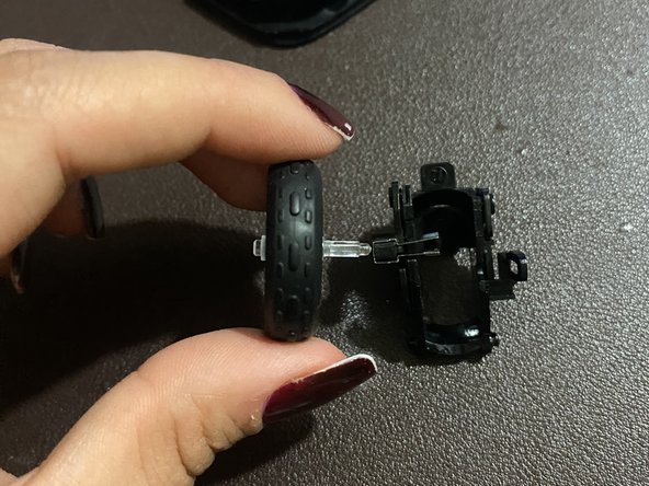

      • Disconnect the scroll wheel sensor from the mouse backing.
      • Remove the old wheel from the plastic casing, and set it aside.

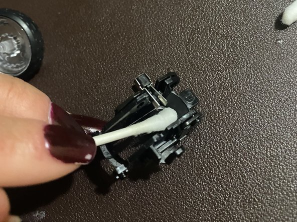

      • Use a dry cotton swab to wipe off dust or debris in the wheel's plastic casing.

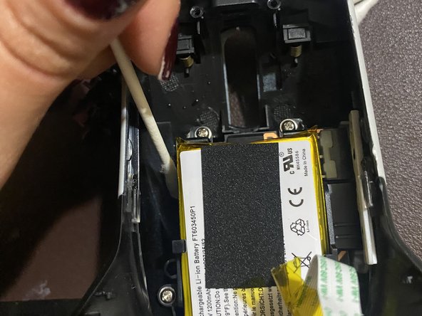

      • Dip a cotton swab into hydrogen-peroxide.
      • Make sure to wear gloves or wash your hands after handling hydrogen peroxide. Be cautious to avoid touching your face in this step.

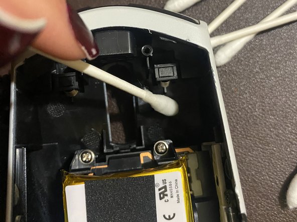

      • Use a wet cotton swab to clean the mouse backing. Don't hesitate to swipe behind different pieces of plastic as well.
      • Avoid using cotton swabs on the circuit board of the mouse, or any wires in the mouse.

Note: the tan part connected to the ribbon cable IS A RECEPTACLE, THE RIBBON CABLE ITSELF IS THE PART THAT PULLS OUT. I accidentally pulled off my connector, lost a connector pin when attempting to put it back on, mouse still seems to work though.
