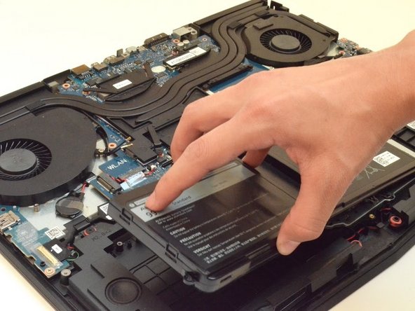

  23. Alienware 17 R4 Battery Replacement, Battery: crwdns2935265:023crwdnd2935265:01crwdnd2935265:03crwdne2935265:0 Alienware 17 R4 Battery Replacement, Battery: crwdns2935265:023crwdnd2935265:02crwdnd2935265:03crwdne2935265:0 Alienware 17 R4 Battery Replacement, Battery: crwdns2935265:023crwdnd2935265:03crwdnd2935265:03crwdne2935265:0
    • Unscrew the four M2.5 screws (2.4 mm) with a PH1 screwdriver bit.
  24. Alienware 17 R4 Battery Replacement: crwdns2935265:024crwdnd2935265:01crwdnd2935265:02crwdne2935265:0 Alienware 17 R4 Battery Replacement: crwdns2935265:024crwdnd2935265:02crwdnd2935265:02crwdne2935265:0
    • Lift the battery up to remove it.
