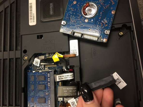

    • Make sure the laptop is unplugged from any power source.
    • Put the laptop facing down on a hard surface.
  2. Alienware 17 R2 Hard Drive Replacement: crwdns2935265:02crwdnd2935265:01crwdnd2935265:03crwdne2935265:0 Alienware 17 R2 Hard Drive Replacement: crwdns2935265:02crwdnd2935265:02crwdnd2935265:03crwdne2935265:0 Alienware 17 R2 Hard Drive Replacement: crwdns2935265:02crwdnd2935265:03crwdnd2935265:03crwdne2935265:0
    • Unscrew the two 6mm screws on the bottom side of the laptop.
    • Lift up the back cover and slide towards you.

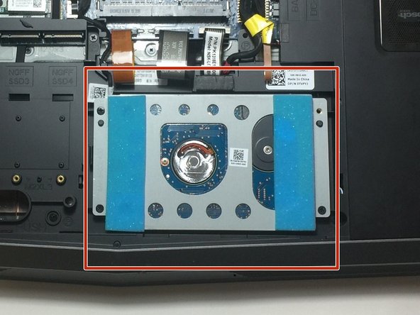

    • Locate the Hard Drive
  4. Alienware 17 R2 Hard Drive Replacement: crwdns2935265:04crwdnd2935265:01crwdnd2935265:01crwdne2935265:0
    • Remove the screws that connect the SSD Bay to the laptop

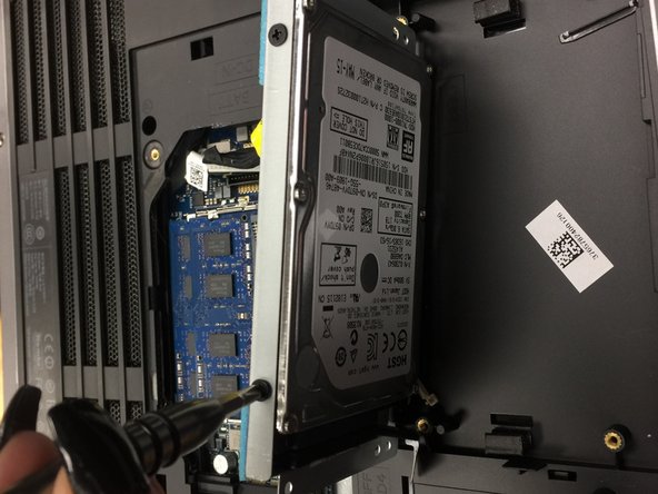

  5. Alienware 17 R2 Hard Drive Replacement: crwdns2935265:05crwdnd2935265:01crwdnd2935265:01crwdne2935265:0
    • Unscrew the three screws holding the hard drive
  6. Alienware 17 R2 Hard Drive Replacement: crwdns2935265:06crwdnd2935265:01crwdnd2935265:02crwdne2935265:0 Alienware 17 R2 Hard Drive Replacement: crwdns2935265:06crwdnd2935265:02crwdnd2935265:02crwdne2935265:0
    • Unscrew the four screws on the long sides of the hard drive casing

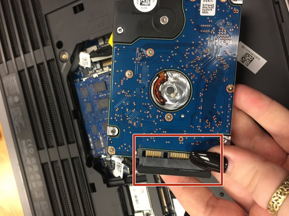

  7. Alienware 17 R2 Hard Drive Replacement: crwdns2935265:07crwdnd2935265:01crwdnd2935265:03crwdne2935265:0 Alienware 17 R2 Hard Drive Replacement: crwdns2935265:07crwdnd2935265:02crwdnd2935265:03crwdne2935265:0 Alienware 17 R2 Hard Drive Replacement: crwdns2935265:07crwdnd2935265:03crwdnd2935265:03crwdne2935265:0
    • Now that the hard drive casing is off, carefully unplug the hard drive from the laptop
    • Your hard drive has now been successfully removed from your device
