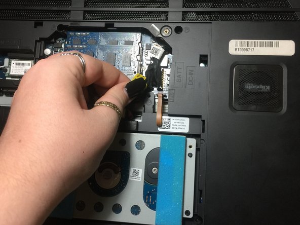

    3. Alienware 17 R2 Battery Replacement: crwdns2935265:03crwdnd2935265:01crwdnd2935265:03crwdne2935265:0 Alienware 17 R2 Battery Replacement: crwdns2935265:03crwdnd2935265:02crwdnd2935265:03crwdne2935265:0 Alienware 17 R2 Battery Replacement: crwdns2935265:03crwdnd2935265:03crwdnd2935265:03crwdne2935265:0
      • Carefully unplug the black cord with the yellow tag to disconnect the battery.

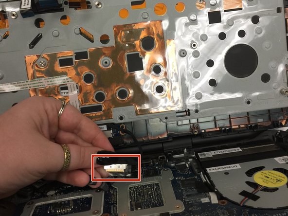

    6. Alienware 17 R2 Battery Replacement: crwdns2935265:06crwdnd2935265:01crwdnd2935265:03crwdne2935265:0 Alienware 17 R2 Battery Replacement: crwdns2935265:06crwdnd2935265:02crwdnd2935265:03crwdne2935265:0 Alienware 17 R2 Battery Replacement: crwdns2935265:06crwdnd2935265:03crwdnd2935265:03crwdne2935265:0
      • Slowly separate the palm rest from the laptop.
      • Disconnect the power cord from the laptop to the palm rest.
      • Remove the palm rest.

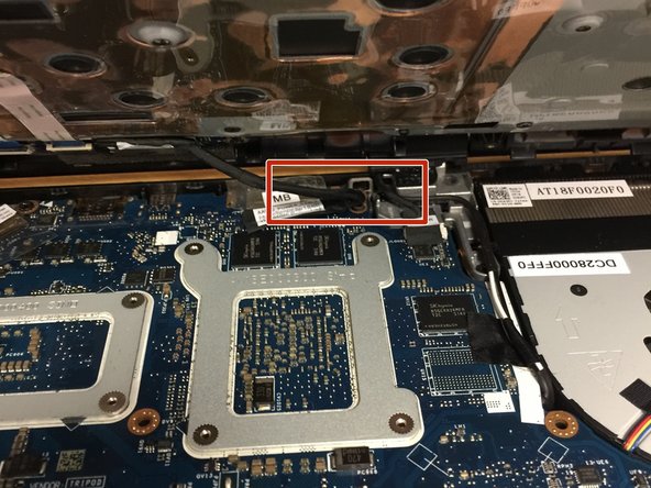

    7. Alienware 17 R2 Battery Replacement: crwdns2935265:07crwdnd2935265:01crwdnd2935265:01crwdne2935265:0
      • Unplug the two cables from the laptop.

Many thanks for a decent write up. My only observation was that I don't know why there was a need to unplug the power to the palm rest and fully remove it? You have access to the battery once the palm rest is lifted. Good write up non the less
mark dale - crwdns2934203:0crwdne2934203:0 crwdns2950251:0crwdne2950251:0
I agree with Mark. No need to unplug the cable to the palm rest.
lrshapiro - crwdns2934203:0crwdne2934203:0 crwdns2950251:0crwdne2950251:0
