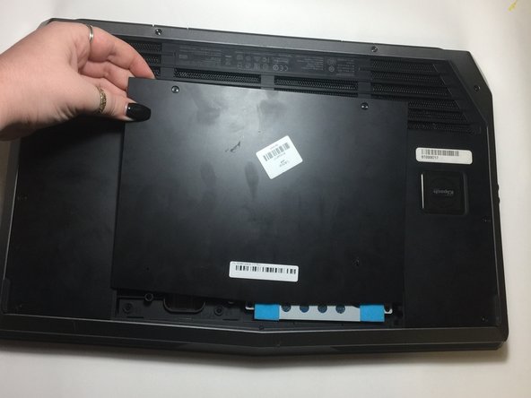

    • To unplug the battery, turn the computer upside down.
    • Remove the two 4mm screws from the plastic covering protecting the inner part of the laptop.
  3. Alienware 17 R2  Screen Replacement: crwdns2935265:03crwdnd2935265:01crwdnd2935265:02crwdne2935265:0 Alienware 17 R2  Screen Replacement: crwdns2935265:03crwdnd2935265:02crwdnd2935265:02crwdne2935265:0
    • Gently, pull the cover up and slide it off.

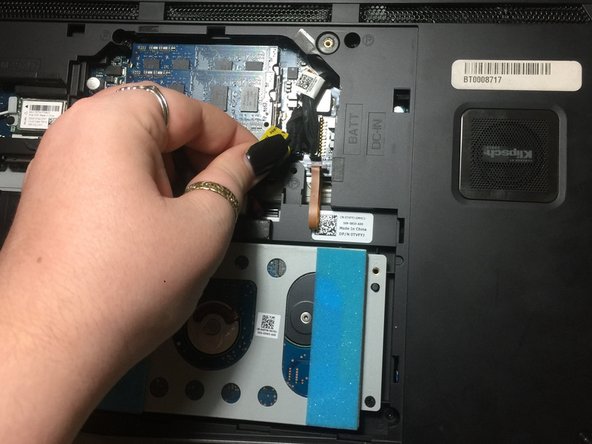

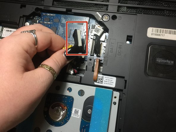

  4. Alienware 17 R2  Screen Replacement: crwdns2935265:04crwdnd2935265:01crwdnd2935265:03crwdne2935265:0 Alienware 17 R2  Screen Replacement: crwdns2935265:04crwdnd2935265:02crwdnd2935265:03crwdne2935265:0 Alienware 17 R2  Screen Replacement: crwdns2935265:04crwdnd2935265:03crwdnd2935265:03crwdne2935265:0
    • Now, you are going to look for a yellow tag.
    • Unplug the black wire that has the yellow tag.
    • This with successfully disconnect your battery.

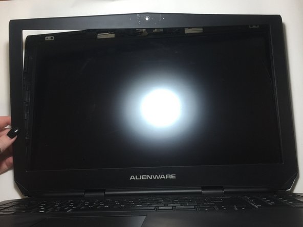

  5. Alienware 17 R2  Screen Replacement: crwdns2935265:05crwdnd2935265:01crwdnd2935265:02crwdne2935265:0 Alienware 17 R2  Screen Replacement: crwdns2935265:05crwdnd2935265:02crwdnd2935265:02crwdne2935265:0
    • Using the plastic opening tool, gently remove the black plastic casing from the LCD screen.
    • Run the opening tool along the inner side of the computer where the screen and the plastic covering meet.
