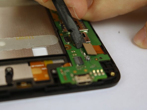

    • Use a spudger to flip up the retaining flap on the USB ribbon cable ZIF socket.
    • Slide the ribbon cable out of the socket.

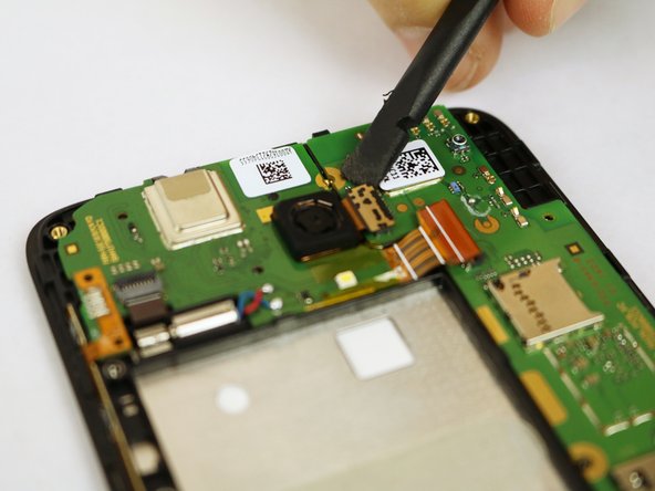

  6. Alcatel Pop 4 Plus Motherboard Replacement: crwdns2935265:06crwdnd2935265:01crwdnd2935265:02crwdne2935265:0 Alcatel Pop 4 Plus Motherboard Replacement: crwdns2935265:06crwdnd2935265:02crwdnd2935265:02crwdne2935265:0
    • Use the flat end of a spudger to disconnect the ribbon cable.

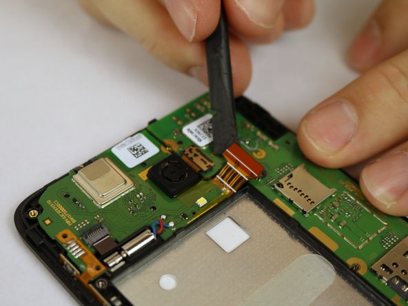

  7. Alcatel Pop 4 Plus Motherboard Replacement: crwdns2935265:07crwdnd2935265:01crwdnd2935265:02crwdne2935265:0 Alcatel Pop 4 Plus Motherboard Replacement: crwdns2935265:07crwdnd2935265:02crwdnd2935265:02crwdne2935265:0
    • Using the flat end of the spudger to disconnect the ribbon cable.
  8. Alcatel Pop 4 Plus Motherboard Replacement: crwdns2935265:08crwdnd2935265:01crwdnd2935265:02crwdne2935265:0 Alcatel Pop 4 Plus Motherboard Replacement: crwdns2935265:08crwdnd2935265:02crwdnd2935265:02crwdne2935265:0
    • Using the flat end of the spudger, disconnect the camera from the motherboard.
