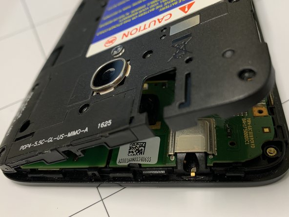

  3. Alcatel Pop 4 Plus Headphone Jack Replacement: crwdns2935265:03crwdnd2935265:01crwdnd2935265:02crwdne2935265:0 Alcatel Pop 4 Plus Headphone Jack Replacement: crwdns2935265:03crwdnd2935265:02crwdnd2935265:02crwdne2935265:0
    • Once the screws have been taken out, remove the mid-frame protecting the phone's electronics by using a fingernail or tool to pry it off.

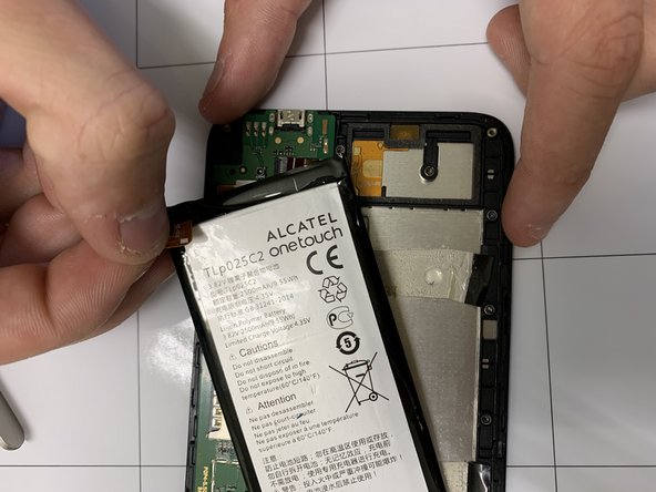

  4. Alcatel Pop 4 Plus Headphone Jack Replacement: crwdns2935265:04crwdnd2935265:01crwdnd2935265:03crwdne2935265:0 Alcatel Pop 4 Plus Headphone Jack Replacement: crwdns2935265:04crwdnd2935265:02crwdnd2935265:03crwdne2935265:0 Alcatel Pop 4 Plus Headphone Jack Replacement: crwdns2935265:04crwdnd2935265:03crwdnd2935265:03crwdne2935265:0
    • Disconnect the battery from the motherboard and remove it.

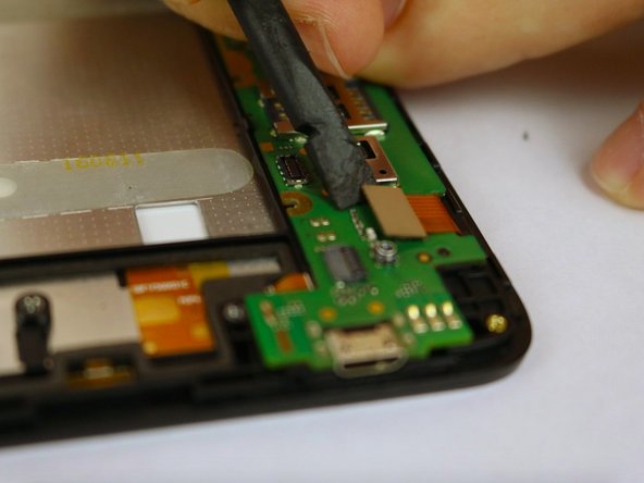

  5. Alcatel Pop 4 Plus Headphone Jack Replacement: crwdns2935265:05crwdnd2935265:01crwdnd2935265:02crwdne2935265:0 Alcatel Pop 4 Plus Headphone Jack Replacement: crwdns2935265:05crwdnd2935265:02crwdnd2935265:02crwdne2935265:0
    • Unhook the USB ribbon from the motherboard.
  6. Alcatel Pop 4 Plus Headphone Jack Replacement: crwdns2935265:06crwdnd2935265:01crwdnd2935265:02crwdne2935265:0 Alcatel Pop 4 Plus Headphone Jack Replacement: crwdns2935265:06crwdnd2935265:02crwdnd2935265:02crwdne2935265:0
    • Disconnect the phone's ribbon cable from the mother board.

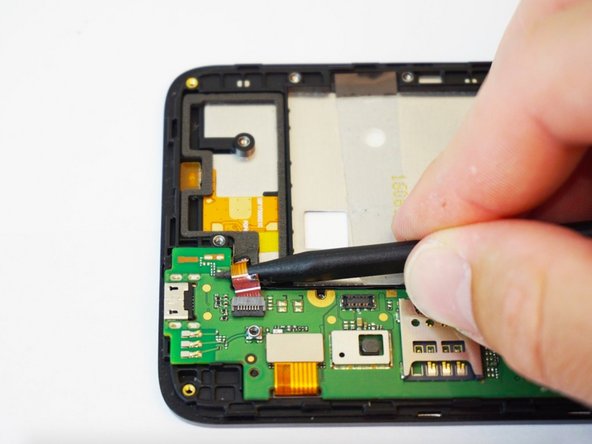

  7. Alcatel Pop 4 Plus Headphone Jack Replacement: crwdns2935265:07crwdnd2935265:01crwdnd2935265:02crwdne2935265:0 Alcatel Pop 4 Plus Headphone Jack Replacement: crwdns2935265:07crwdnd2935265:02crwdnd2935265:02crwdne2935265:0
    • Disconnect the ribbon cable that binds the two motherboards together.

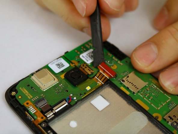

  8. Alcatel Pop 4 Plus Headphone Jack Replacement: crwdns2935265:08crwdnd2935265:01crwdnd2935265:02crwdne2935265:0 Alcatel Pop 4 Plus Headphone Jack Replacement: crwdns2935265:08crwdnd2935265:02crwdnd2935265:02crwdne2935265:0
    • Remove the phone's rear camera from the motherboard.

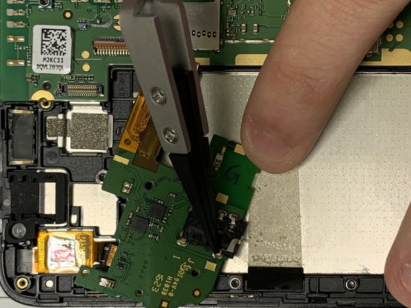

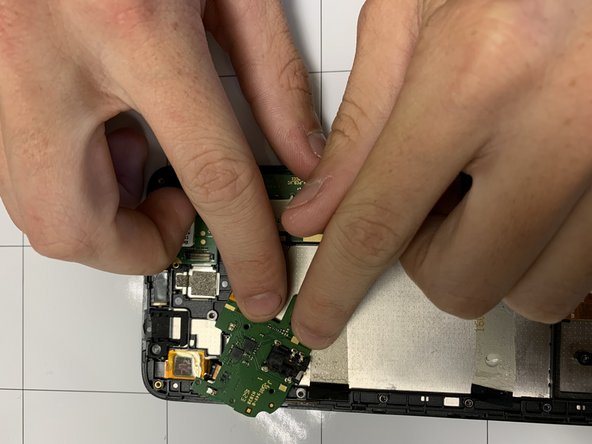

  9. Alcatel Pop 4 Plus Headphone Jack Replacement: crwdns2935265:09crwdnd2935265:01crwdnd2935265:01crwdne2935265:0
    • Insert a flat tool at the edge of the phone and gently lift to remove the motherboard.

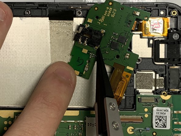

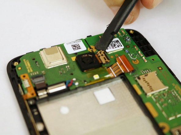

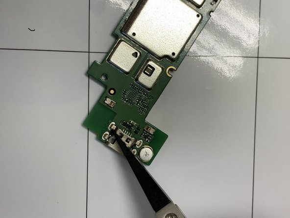

  10. Alcatel Pop 4 Plus Headphone Jack Replacement: crwdns2935265:010crwdnd2935265:01crwdnd2935265:03crwdne2935265:0 Alcatel Pop 4 Plus Headphone Jack Replacement: crwdns2935265:010crwdnd2935265:02crwdnd2935265:03crwdne2935265:0 Alcatel Pop 4 Plus Headphone Jack Replacement: crwdns2935265:010crwdnd2935265:03crwdnd2935265:03crwdne2935265:0
    • Locate the phone's headphone jack on the motherboard.
  11. Alcatel Pop 4 Plus Headphone Jack Replacement: crwdns2935265:011crwdnd2935265:01crwdnd2935265:03crwdne2935265:0 Alcatel Pop 4 Plus Headphone Jack Replacement: crwdns2935265:011crwdnd2935265:02crwdnd2935265:03crwdne2935265:0 Alcatel Pop 4 Plus Headphone Jack Replacement: crwdns2935265:011crwdnd2935265:03crwdnd2935265:03crwdne2935265:0
