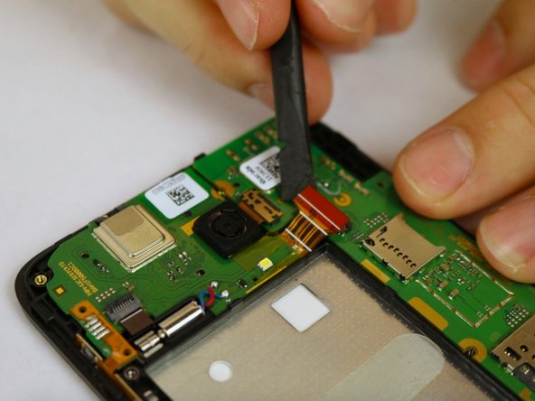

  6. Alcatel Pop 4 Plus Charging Port Replacement: crwdns2935265:06crwdnd2935265:01crwdnd2935265:02crwdne2935265:0 Alcatel Pop 4 Plus Charging Port Replacement: crwdns2935265:06crwdnd2935265:02crwdnd2935265:02crwdne2935265:0
    • Disconnect the phone's ribbon cable.
  7. Alcatel Pop 4 Plus Charging Port Replacement: crwdns2935265:07crwdnd2935265:01crwdnd2935265:02crwdne2935265:0 Alcatel Pop 4 Plus Charging Port Replacement: crwdns2935265:07crwdnd2935265:02crwdnd2935265:02crwdne2935265:0
    • Disconnect the ribbon cable from the phone

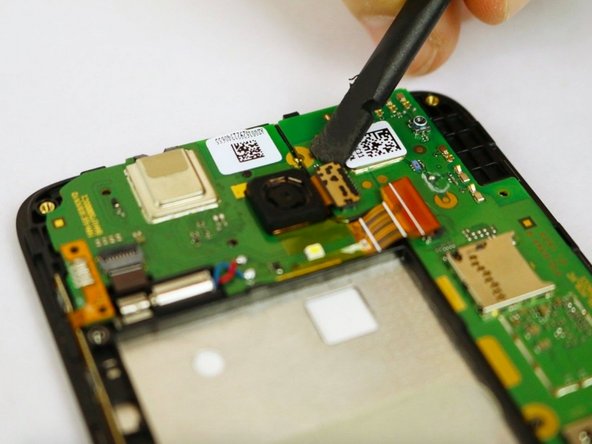

  8. Alcatel Pop 4 Plus Charging Port Replacement: crwdns2935265:08crwdnd2935265:01crwdnd2935265:02crwdne2935265:0 Alcatel Pop 4 Plus Charging Port Replacement: crwdns2935265:08crwdnd2935265:02crwdnd2935265:02crwdne2935265:0
    • Remove the phone's rear camera from the motherboard.

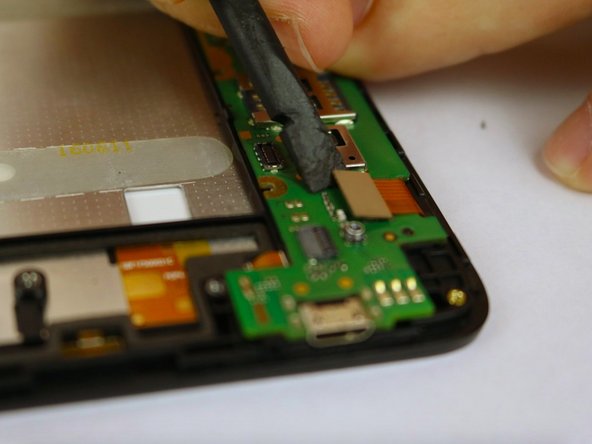

  9. Alcatel Pop 4 Plus Charging Port Replacement: crwdns2935265:09crwdnd2935265:01crwdnd2935265:01crwdne2935265:0
    • Use the flat end of the spudger to pry off the motherboard.
