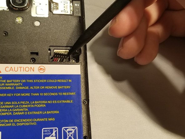

  4. Alcatel Pixi Theatre Motherboard Replacement: crwdns2935265:04crwdnd2935265:01crwdnd2935265:02crwdne2935265:0 Alcatel Pixi Theatre Motherboard Replacement: crwdns2935265:04crwdnd2935265:02crwdnd2935265:02crwdne2935265:0
    • Disconnect the battery connector flex cable by sliding the black spudger under the wires and carefully prying up the entire terminal casing.

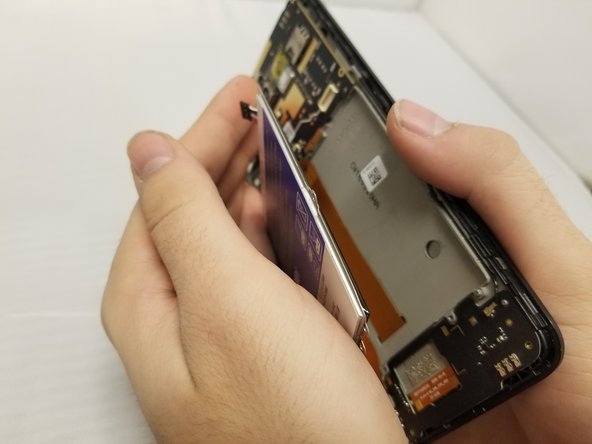

  6. Alcatel Pixi Theatre Motherboard Replacement: crwdns2935265:06crwdnd2935265:01crwdnd2935265:03crwdne2935265:0 Alcatel Pixi Theatre Motherboard Replacement: crwdns2935265:06crwdnd2935265:02crwdnd2935265:03crwdne2935265:0 Alcatel Pixi Theatre Motherboard Replacement: crwdns2935265:06crwdnd2935265:03crwdnd2935265:03crwdne2935265:0
    • Remove the blue battery by lifting it straight up, or by gently turning the phone over into your palm and catching the battery as it comes out.

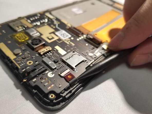

  8. Alcatel Pixi Theatre Motherboard Replacement: crwdns2935265:08crwdnd2935265:01crwdnd2935265:01crwdne2935265:0
    • Disconnect the antenna flex cable by gently prying up the golden connection with the black spudger.
    • Slide the pointed end gently under the socket until it releases and hangs loose.

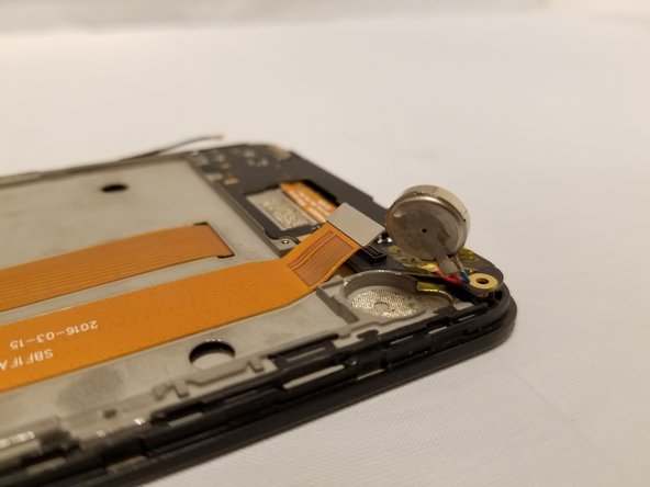

  9. Alcatel Pixi Theatre Motherboard Replacement: crwdns2935265:09crwdnd2935265:01crwdnd2935265:02crwdne2935265:0 Alcatel Pixi Theatre Motherboard Replacement: crwdns2935265:09crwdnd2935265:02crwdnd2935265:02crwdne2935265:0
    • Be sure that you're reaching down far enough into the crack before you begin prying the vibrator up, or you could break it.
    • Carefully pry up the vibrator with the black spudger, being mindful of its connecting wires. Do not disconnect the vibrator from the board.

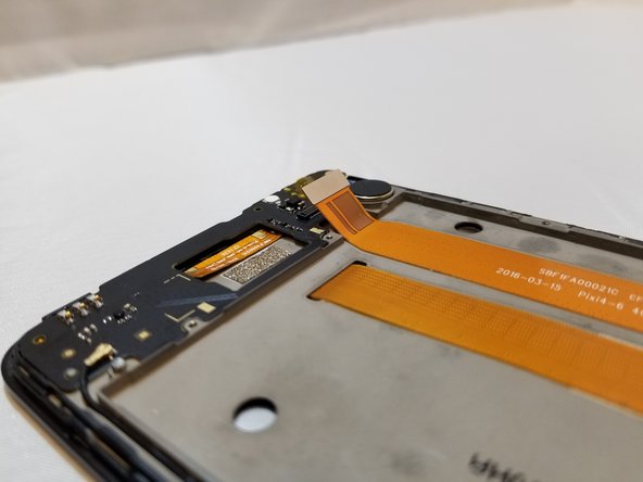

  10. Alcatel Pixi Theatre Motherboard Replacement: crwdns2935265:010crwdnd2935265:01crwdnd2935265:02crwdne2935265:0 Alcatel Pixi Theatre Motherboard Replacement: crwdns2935265:010crwdnd2935265:02crwdnd2935265:02crwdne2935265:0
    • Using the black spudger, pry off the board the USB charging port is attached to.

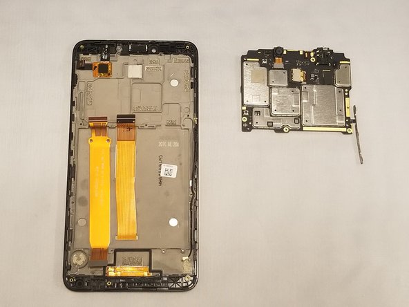

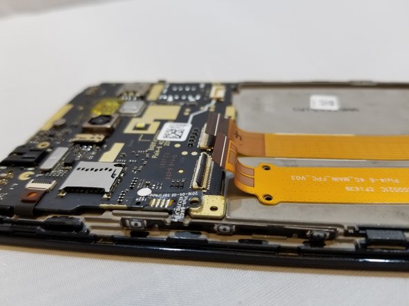

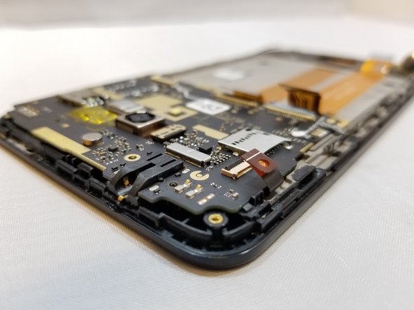

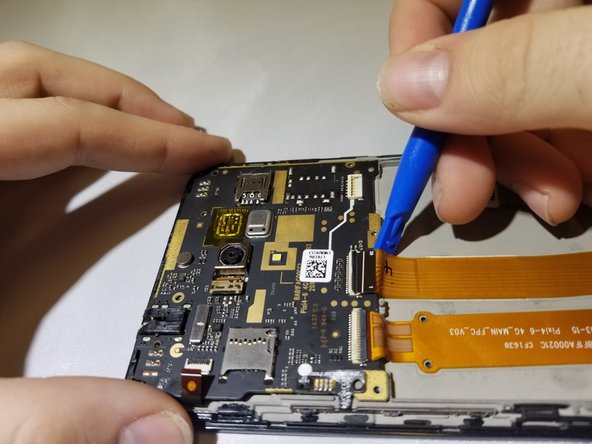

  11. Alcatel Pixi Theatre Motherboard Replacement, Motherboard: crwdns2935265:011crwdnd2935265:01crwdnd2935265:03crwdne2935265:0 Alcatel Pixi Theatre Motherboard Replacement, Motherboard: crwdns2935265:011crwdnd2935265:02crwdnd2935265:03crwdne2935265:0 Alcatel Pixi Theatre Motherboard Replacement, Motherboard: crwdns2935265:011crwdnd2935265:03crwdnd2935265:03crwdne2935265:0
    • When disconnecting the ribbon cables from the clamps, do not peel the cables up. They're glued down.
    • Turn the phone so the volume buttons are facing you.
    • Disconnect the orange ribbon cables from the motherboard. Flip the black switches with the blue spudger.
    • Gently pull the ribbons away from the clamp by lifting them away from the connection with the blue spudger. It should release and hang loose.
  12. Alcatel Pixi Theatre Motherboard Replacement: crwdns2935265:012crwdnd2935265:01crwdnd2935265:03crwdne2935265:0 Alcatel Pixi Theatre Motherboard Replacement: crwdns2935265:012crwdnd2935265:02crwdnd2935265:03crwdne2935265:0 Alcatel Pixi Theatre Motherboard Replacement: crwdns2935265:012crwdnd2935265:03crwdnd2935265:03crwdne2935265:0
    • Disconnect the small black flex cable by flipping its switch with the flat side of the black spudger.
    • Using the pointy side of the black spudger, gently move the cable away from the connection without pulling on it.
  13. Alcatel Pixi Theatre Motherboard Replacement: crwdns2935265:013crwdnd2935265:01crwdnd2935265:03crwdne2935265:0 Alcatel Pixi Theatre Motherboard Replacement: crwdns2935265:013crwdnd2935265:02crwdnd2935265:03crwdne2935265:0 Alcatel Pixi Theatre Motherboard Replacement: crwdns2935265:013crwdnd2935265:03crwdnd2935265:03crwdne2935265:0
    • The volume buttons are attached with adhesive. Make sure you're prying them out as gently and evenly as possible to avoid damage.
    • Remove the volume buttons on the side by inserting the Jimmy between the buttons and the phone and gently prying them outward. Do not remove the volume buttons from the motherboard.

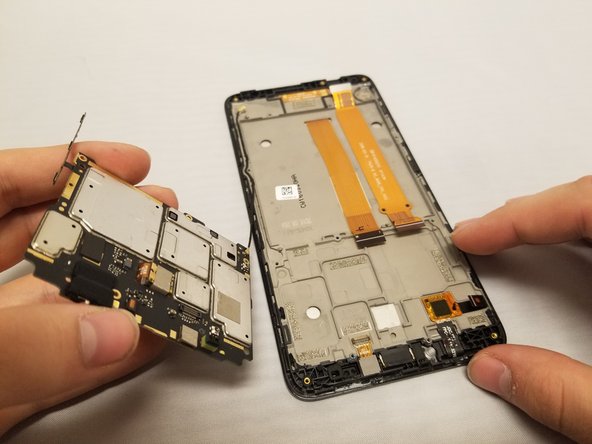

  14. Alcatel Pixi Theatre Motherboard Replacement: crwdns2935265:014crwdnd2935265:01crwdnd2935265:02crwdne2935265:0 Alcatel Pixi Theatre Motherboard Replacement: crwdns2935265:014crwdnd2935265:02crwdnd2935265:02crwdne2935265:0
    • Be wary of remaining adhesive from the volume buttons when removing the motherboard.
    • Start prying from the top left of the phone to minimize the possibility of damage.
    • Gently pry up the motherboard with the black spudger to remove it.
  15. Alcatel Pixi Theatre Motherboard Replacement: crwdns2935265:015crwdnd2935265:01crwdnd2935265:02crwdne2935265:0 Alcatel Pixi Theatre Motherboard Replacement: crwdns2935265:015crwdnd2935265:02crwdnd2935265:02crwdne2935265:0
    • Gently lift the motherboard up with your hand and slowly turn it over so the antenna's connection on the bottom is visible.
    • Disconnect the antenna from the motherboard by putting the black spudger under the connection and gently lifting the cable upwards.
