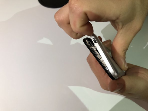

    • Locate the small indent on the lower left corner.
    • Use your fingers or a small plastic opening tool to lift the back cover off.
