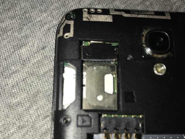

    • Locate the small indent on the lower left corner.
    • Use your fingers or a small plastic opening tool to lift the back cover off.
  2. Alcatel OneTouch Elevate SIM Card Replacement: crwdns2935265:02crwdnd2935265:01crwdnd2935265:03crwdne2935265:0 Alcatel OneTouch Elevate SIM Card Replacement: crwdns2935265:02crwdnd2935265:02crwdnd2935265:03crwdne2935265:0 Alcatel OneTouch Elevate SIM Card Replacement: crwdns2935265:02crwdnd2935265:03crwdnd2935265:03crwdne2935265:0
    • Locate the indent between the battery and your phone.
    • Use your finger or a small plastic opening tool to lift the battery free.
  3. Alcatel OneTouch Elevate SIM Card Replacement, SIM card: crwdns2935265:03crwdnd2935265:01crwdnd2935265:02crwdne2935265:0 Alcatel OneTouch Elevate SIM Card Replacement, SIM card: crwdns2935265:03crwdnd2935265:02crwdnd2935265:02crwdne2935265:0
    • Locate the SIM card slot at the top left of the phone.
    • If an SIM card is not present, you can skip to step 4
  4. Alcatel OneTouch Elevate SIM Card Replacement: crwdns2935265:04crwdnd2935265:01crwdnd2935265:01crwdne2935265:0
    • The SIM card will have an indent at the top, use this to carefully pull the card from the slot.
  5. Alcatel OneTouch Elevate SIM Card Replacement: crwdns2935265:05crwdnd2935265:01crwdnd2935265:02crwdne2935265:0 Alcatel OneTouch Elevate SIM Card Replacement: crwdns2935265:05crwdnd2935265:02crwdnd2935265:02crwdne2935265:0
    • Grab the new SIM card making sure not to touch the metallic area.
    • With the metallic patch facing down, insert the card into the slot.
