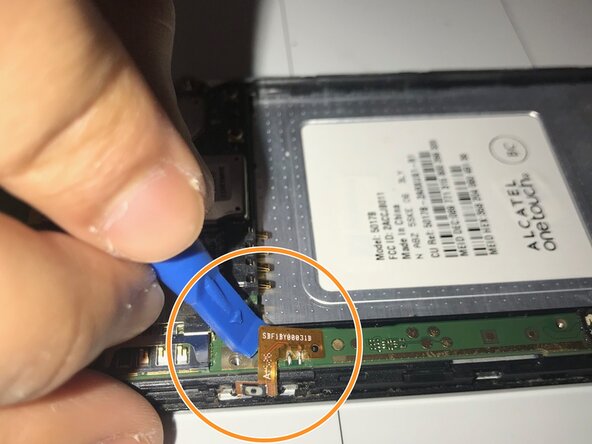

  2. Alcatel OneTouch Elevate Rear Camera Replacement: crwdns2935265:02crwdnd2935265:01crwdnd2935265:03crwdne2935265:0 Alcatel OneTouch Elevate Rear Camera Replacement: crwdns2935265:02crwdnd2935265:02crwdnd2935265:03crwdne2935265:0 Alcatel OneTouch Elevate Rear Camera Replacement: crwdns2935265:02crwdnd2935265:03crwdnd2935265:03crwdne2935265:0
    • Locate the indent between the battery and your phone.
    • Use your finger or a small plastic opening tool to lift the battery free.

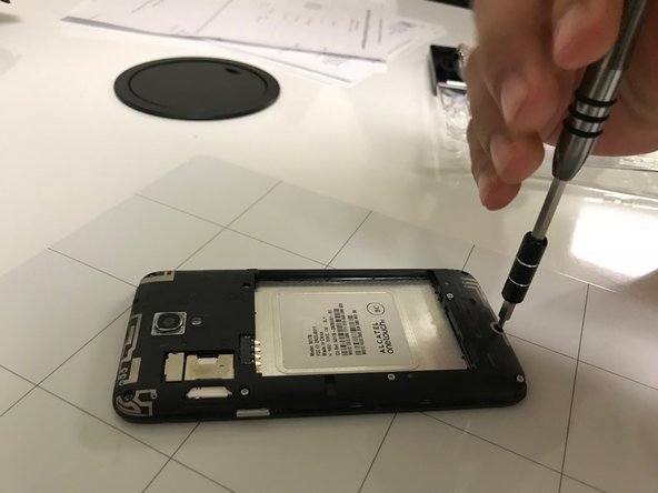

  3. Alcatel OneTouch Elevate Rear Camera Replacement, Motherboard: crwdns2935265:03crwdnd2935265:01crwdnd2935265:03crwdne2935265:0 Alcatel OneTouch Elevate Rear Camera Replacement, Motherboard: crwdns2935265:03crwdnd2935265:02crwdnd2935265:03crwdne2935265:0 Alcatel OneTouch Elevate Rear Camera Replacement, Motherboard: crwdns2935265:03crwdnd2935265:03crwdnd2935265:03crwdne2935265:0
    • Using the Phillips #0 screwdriver, remove the nine screws from the phone.

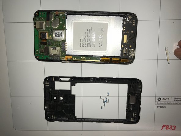

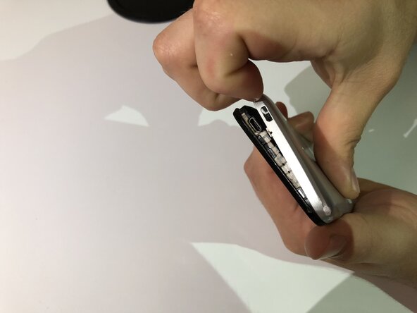

  4. Alcatel OneTouch Elevate Rear Camera Replacement: crwdns2935265:04crwdnd2935265:01crwdnd2935265:01crwdne2935265:0
    • Place an iFixit opening tool between the screen and the back cover and pry it open.

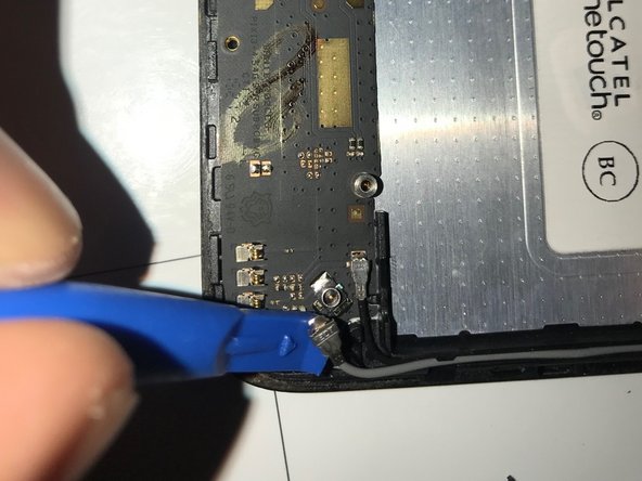

  5. Alcatel OneTouch Elevate Rear Camera Replacement: crwdns2935265:05crwdnd2935265:01crwdnd2935265:02crwdne2935265:0 Alcatel OneTouch Elevate Rear Camera Replacement: crwdns2935265:05crwdnd2935265:02crwdnd2935265:02crwdne2935265:0
    • Disconnect the camera from the mother board with your prying tool.
  6. Alcatel OneTouch Elevate Rear Camera Replacement: crwdns2935265:06crwdnd2935265:01crwdnd2935265:03crwdne2935265:0 Alcatel OneTouch Elevate Rear Camera Replacement: crwdns2935265:06crwdnd2935265:02crwdnd2935265:03crwdne2935265:0 Alcatel OneTouch Elevate Rear Camera Replacement: crwdns2935265:06crwdnd2935265:03crwdnd2935265:03crwdne2935265:0
    • Remove both of the cables located on the bottom left corner of the phone.

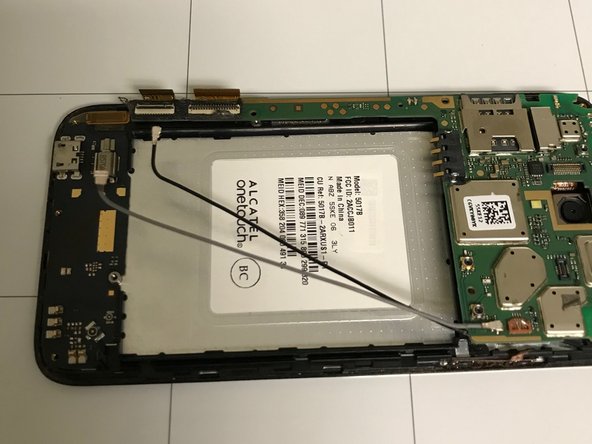

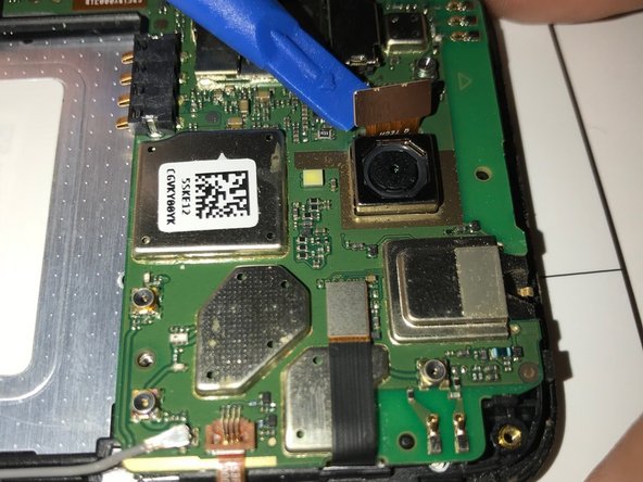

  11. Alcatel OneTouch Elevate Rear Camera Replacement, Rear Camera: crwdns2935265:011crwdnd2935265:01crwdnd2935265:01crwdne2935265:0
    • Find the camera and look for one of the corner where there is no border around the camera. (Red circle)
  12. Alcatel OneTouch Elevate Rear Camera Replacement: crwdns2935265:012crwdnd2935265:01crwdnd2935265:01crwdne2935265:0
    • Gently put the opening tool head as close as possible to the edge, where the camera and the phone stick.
  13. Alcatel OneTouch Elevate Rear Camera Replacement: crwdns2935265:013crwdnd2935265:01crwdnd2935265:01crwdne2935265:0
    • Flip the camera up carefully and slowly.
  14. Alcatel OneTouch Elevate Rear Camera Replacement: crwdns2935265:014crwdnd2935265:01crwdnd2935265:01crwdne2935265:0
    • Put the old camera out and replace with the replacement.
    • Gently press on the camera and wait for it to stick back to the phone.
