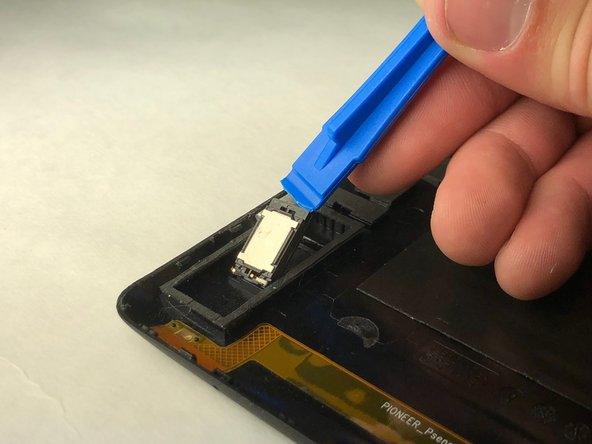

  4. Alcatel One Touch Pop 7 Speaker Replacement: crwdns2935265:04crwdnd2935265:01crwdnd2935265:02crwdne2935265:0 Alcatel One Touch Pop 7 Speaker Replacement: crwdns2935265:04crwdnd2935265:02crwdnd2935265:02crwdne2935265:0
    • Using the plastic opening tool, dig under the silver speaker to remove it from the back cover.
