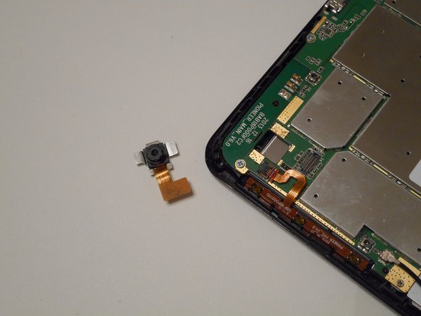

  5. Alcatel One Touch Pop 7 Motherboard Replacement, Rear Camera: crwdns2935265:05crwdnd2935265:01crwdnd2935265:02crwdne2935265:0 Alcatel One Touch Pop 7 Motherboard Replacement, Rear Camera: crwdns2935265:05crwdnd2935265:02crwdnd2935265:02crwdne2935265:0
    • The camera is in the top left corner of the tablet. To begin removal, use the tweezers to gently disconnect the ribbon cable attached to the camera.
  6. Alcatel One Touch Pop 7 Motherboard Replacement: crwdns2935265:06crwdnd2935265:01crwdnd2935265:02crwdne2935265:0 Alcatel One Touch Pop 7 Motherboard Replacement: crwdns2935265:06crwdnd2935265:02crwdnd2935265:02crwdne2935265:0
    • Pull the actual camera piece from the camera slot. It may stick a bit but it shouldn't be too difficult.

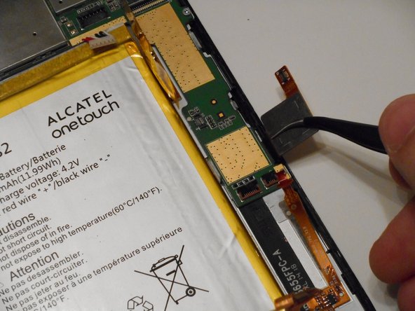

  7. Alcatel One Touch Pop 7 Motherboard Replacement, WIFI Antenna: crwdns2935265:07crwdnd2935265:01crwdnd2935265:02crwdne2935265:0 Alcatel One Touch Pop 7 Motherboard Replacement, WIFI Antenna: crwdns2935265:07crwdnd2935265:02crwdnd2935265:02crwdne2935265:0
    • Using the tweezers, pull the WIFI Antenna away from the motherboard and the wireless card.
  8. Alcatel One Touch Pop 7 Motherboard Replacement: crwdns2935265:08crwdnd2935265:01crwdnd2935265:02crwdne2935265:0 Alcatel One Touch Pop 7 Motherboard Replacement: crwdns2935265:08crwdnd2935265:02crwdnd2935265:02crwdne2935265:0
    • With each of the antenna ends disconnected, you can pull out the full antenna. There will be 3 pieces of tape wrapped around the antenna and stuck beneath the battery. They may be a bit difficult to remove but not impossible.
