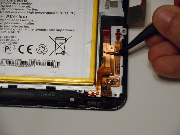

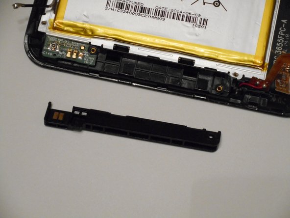

    • Use the plastic opening tools to pry off the plastic piece at the bottom of the device.

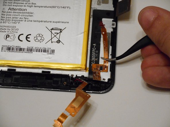

    • Pull away the digitizer ribbon cable using the tweezers. It will stay attached to the front casing.
