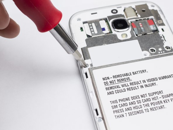

    • Phillips #000 is highly recommended. As you can see i'm too broke for the iFixIt equivalent.
    • The iSesamo is also always handy.

    • With the back plastic removed.
    • "DO NOT REMOVE"
    • Challenge accepted

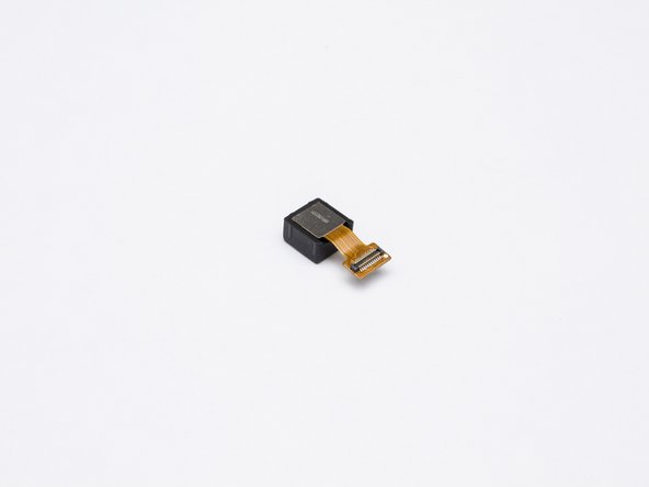

  6. Alcatel One Touch Fierce Teardown: crwdns2935265:06crwdnd2935265:01crwdnd2935265:02crwdne2935265:0 Alcatel One Touch Fierce Teardown: crwdns2935265:06crwdnd2935265:02crwdnd2935265:02crwdne2935265:0

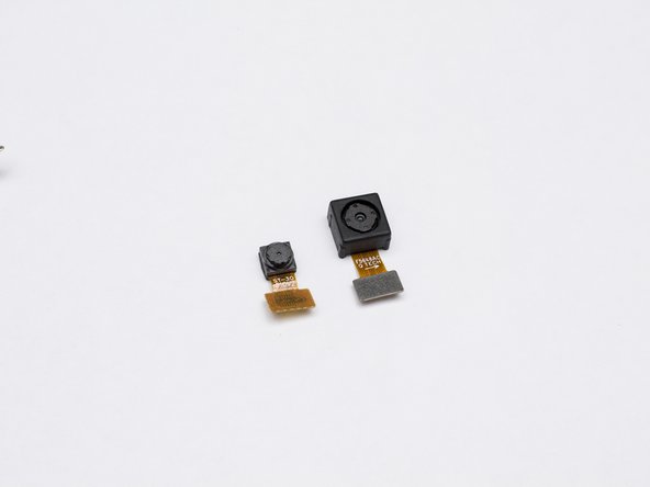

    • The 5MP camera located on the back of the phone.

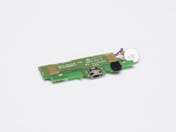

    • The daughter board contains the Micro USB port

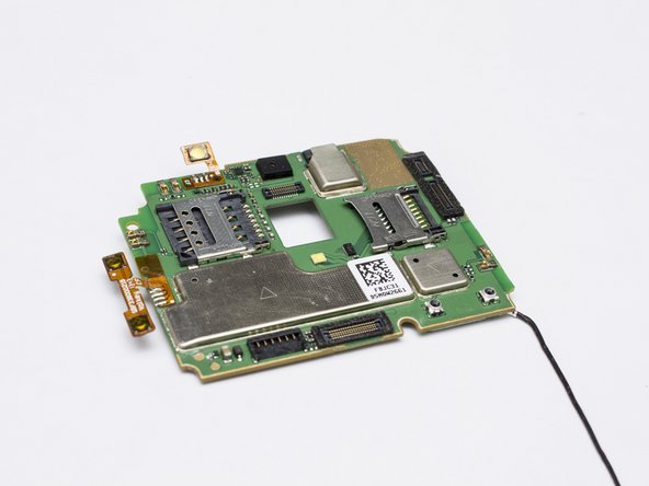

    • The main PCB
  9. Alcatel One Touch Fierce Teardown: crwdns2935265:09crwdnd2935265:01crwdnd2935265:03crwdne2935265:0 Alcatel One Touch Fierce Teardown: crwdns2935265:09crwdnd2935265:02crwdnd2935265:03crwdne2935265:0 Alcatel One Touch Fierce Teardown: crwdns2935265:09crwdnd2935265:03crwdnd2935265:03crwdne2935265:0

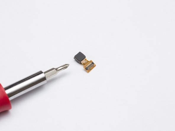

    • The VGA camera located on the front of the phone.

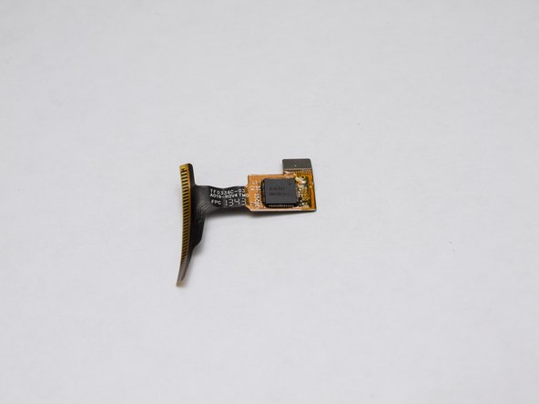

    • The remains of the front panel
  11. Alcatel One Touch Fierce Teardown: crwdns2935265:011crwdnd2935265:01crwdnd2935265:02crwdne2935265:0 Alcatel One Touch Fierce Teardown: crwdns2935265:011crwdnd2935265:02crwdnd2935265:02crwdne2935265:0

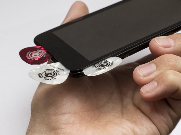

    • Trying to remove the front panel assembly.
    • It seemed to have quite a bit of adhesive.
    • Luckily i have a good amount of picks available.
    • Oh no, i think i hear cracking...
  12. Alcatel One Touch Fierce Teardown, Shoot..: crwdns2935265:012crwdnd2935265:01crwdnd2935265:02crwdne2935265:0 Alcatel One Touch Fierce Teardown, Shoot..: crwdns2935265:012crwdnd2935265:02crwdnd2935265:02crwdne2935265:0
    • Crap! i totally saw this coming.
    • To avoid this use a heat gun to loosen the glue...not too much heat though.
