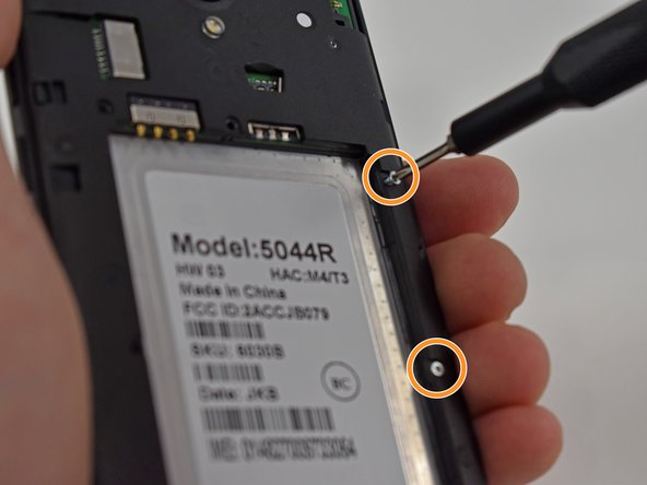

  3. Alcatel IdealXCITE Rear Speaker Replacement, Antenna: crwdns2935265:03crwdnd2935265:01crwdnd2935265:02crwdne2935265:0 Alcatel IdealXCITE Rear Speaker Replacement, Antenna: crwdns2935265:03crwdnd2935265:02crwdnd2935265:02crwdne2935265:0
    • Remove the four 4mm PH00 screws.

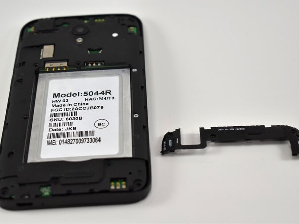

  4. Alcatel IdealXCITE Rear Speaker Replacement: crwdns2935265:04crwdnd2935265:01crwdnd2935265:03crwdne2935265:0 Alcatel IdealXCITE Rear Speaker Replacement: crwdns2935265:04crwdnd2935265:02crwdnd2935265:03crwdne2935265:0 Alcatel IdealXCITE Rear Speaker Replacement: crwdns2935265:04crwdnd2935265:03crwdnd2935265:03crwdne2935265:0
    • Using a spudger, pry upwards in the indentation on the bottom right corner of the phone.
    • Work the tool gently around the antenna to release it.

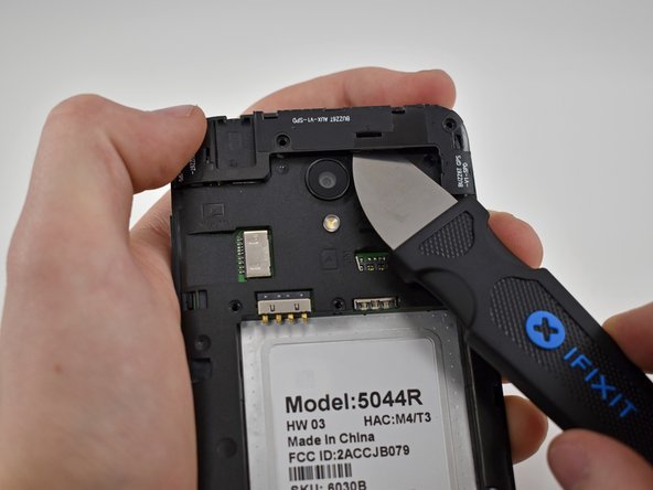

  5. Alcatel IdealXCITE Rear Speaker Replacement, Rear Speaker: crwdns2935265:05crwdnd2935265:01crwdnd2935265:03crwdne2935265:0 Alcatel IdealXCITE Rear Speaker Replacement, Rear Speaker: crwdns2935265:05crwdnd2935265:02crwdnd2935265:03crwdne2935265:0 Alcatel IdealXCITE Rear Speaker Replacement, Rear Speaker: crwdns2935265:05crwdnd2935265:03crwdnd2935265:03crwdne2935265:0
    • Remove the three 4mm PH00 screws holding the WiFi/GPS antenna in.
    • Gently pry the WiFi/GPS antenna out using a Jimmy and set aside.

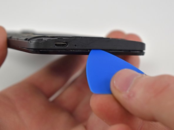

  7. Alcatel IdealXCITE Rear Speaker Replacement: crwdns2935265:07crwdnd2935265:01crwdnd2935265:03crwdne2935265:0 Alcatel IdealXCITE Rear Speaker Replacement: crwdns2935265:07crwdnd2935265:02crwdnd2935265:03crwdne2935265:0 Alcatel IdealXCITE Rear Speaker Replacement: crwdns2935265:07crwdnd2935265:03crwdnd2935265:03crwdne2935265:0
    • Using a spudger and an iFixit opening pick, pry the midframe up.

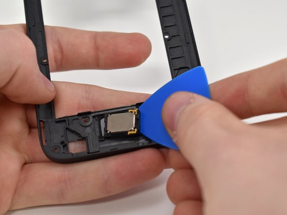

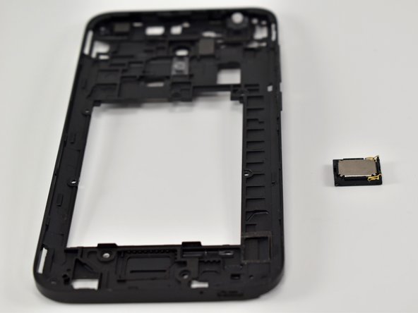

  8. Alcatel IdealXCITE Rear Speaker Replacement: crwdns2935265:08crwdnd2935265:01crwdnd2935265:03crwdne2935265:0 Alcatel IdealXCITE Rear Speaker Replacement: crwdns2935265:08crwdnd2935265:02crwdnd2935265:03crwdne2935265:0 Alcatel IdealXCITE Rear Speaker Replacement: crwdns2935265:08crwdnd2935265:03crwdnd2935265:03crwdne2935265:0
    • Pry gently between the rear case and speaker using an iFixit opening pick.
    • Reapply adhesive to the new speaker when reassembling the phone.
