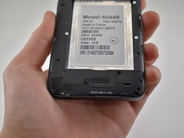

  3. Alcatel IdealXCITE Antenna Replacement, Antenna: crwdns2935265:03crwdnd2935265:01crwdnd2935265:02crwdne2935265:0 Alcatel IdealXCITE Antenna Replacement, Antenna: crwdns2935265:03crwdnd2935265:02crwdnd2935265:02crwdne2935265:0
    • Remove the four 4mm PH00 screws.

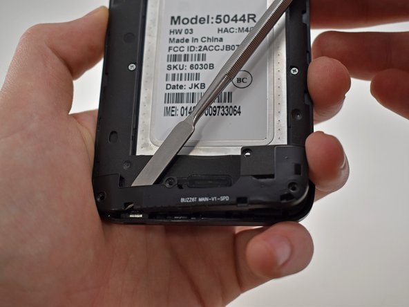

  4. Alcatel IdealXCITE Antenna Replacement: crwdns2935265:04crwdnd2935265:01crwdnd2935265:03crwdne2935265:0 Alcatel IdealXCITE Antenna Replacement: crwdns2935265:04crwdnd2935265:02crwdnd2935265:03crwdne2935265:0 Alcatel IdealXCITE Antenna Replacement: crwdns2935265:04crwdnd2935265:03crwdnd2935265:03crwdne2935265:0
    • Using a spudger, pry upwards in the indentation on the bottom right corner of the phone.
    • Work the tool gently around the antenna to release it.
