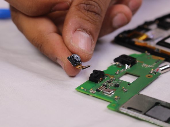

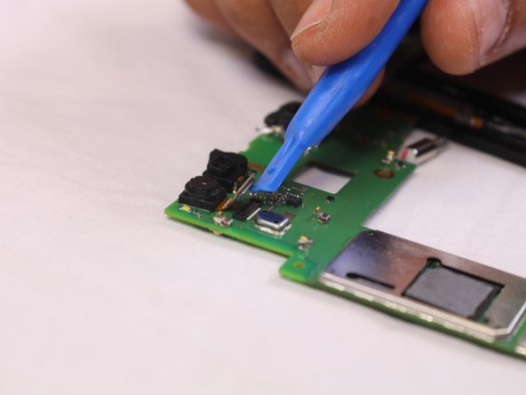

  7. Alcatel Fierce 4 Front-Facing Camera Replacement, Front-Facing Camera: crwdns2935265:07crwdnd2935265:01crwdnd2935265:03crwdne2935265:0 Alcatel Fierce 4 Front-Facing Camera Replacement, Front-Facing Camera: crwdns2935265:07crwdnd2935265:02crwdnd2935265:03crwdne2935265:0 Alcatel Fierce 4 Front-Facing Camera Replacement, Front-Facing Camera: crwdns2935265:07crwdnd2935265:03crwdnd2935265:03crwdne2935265:0
    • Use a plastic opening tool to pry up the camera connector from the motherboard.
    • Remove the camera.
