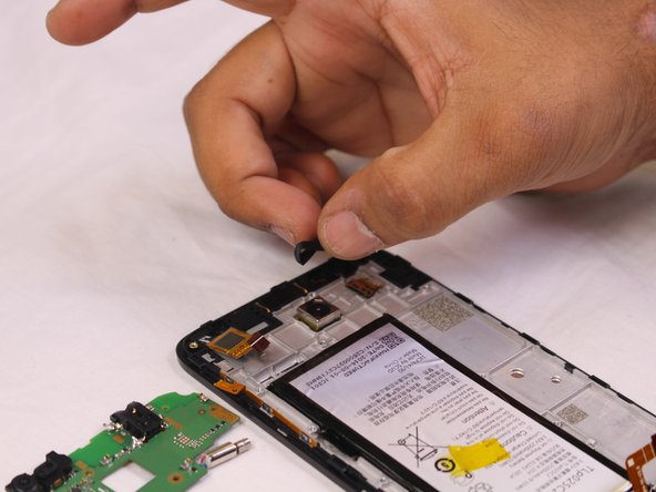

  7. Alcatel Fierce 4 Camera Replacement, Camera: crwdns2935265:07crwdnd2935265:01crwdnd2935265:02crwdne2935265:0 Alcatel Fierce 4 Camera Replacement, Camera: crwdns2935265:07crwdnd2935265:02crwdnd2935265:02crwdne2935265:0
    • Remove the rubber piece surrounding the camera.

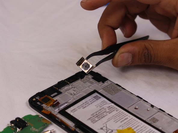

  8. Alcatel Fierce 4 Camera Replacement: crwdns2935265:08crwdnd2935265:01crwdnd2935265:02crwdne2935265:0 Alcatel Fierce 4 Camera Replacement: crwdns2935265:08crwdnd2935265:02crwdnd2935265:02crwdne2935265:0
    • Use a plastic opening tool to pry up the camera.
