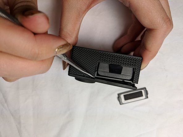

      • Locate the battery cover at the bottom of the camera. Use your fingers to gently pry open the battery cover.
    2. Akaso EK7000 4K Button Replacement: crwdns2935265:02crwdnd2935265:01crwdnd2935265:02crwdne2935265:0 Akaso EK7000 4K Button Replacement: crwdns2935265:02crwdnd2935265:02crwdnd2935265:02crwdne2935265:0
      • Locate the small plastic flap attached to the battery. Pull the battery out towards you.
    1. Akaso EK7000 4K Button Replacement, Front Panel: crwdns2935265:03crwdnd2935265:01crwdnd2935265:02crwdne2935265:0 Akaso EK7000 4K Button Replacement, Front Panel: crwdns2935265:03crwdnd2935265:02crwdnd2935265:02crwdne2935265:0
      • Using the metal spudger, gently pry open the front panel from the exposed battery cartridge.
    2. Akaso EK7000 4K Button Replacement: crwdns2935265:04crwdnd2935265:01crwdnd2935265:02crwdne2935265:0 Akaso EK7000 4K Button Replacement: crwdns2935265:04crwdnd2935265:02crwdnd2935265:02crwdne2935265:0
      • Remove the rest of front panel with your fingers or with assistance from the spudger.

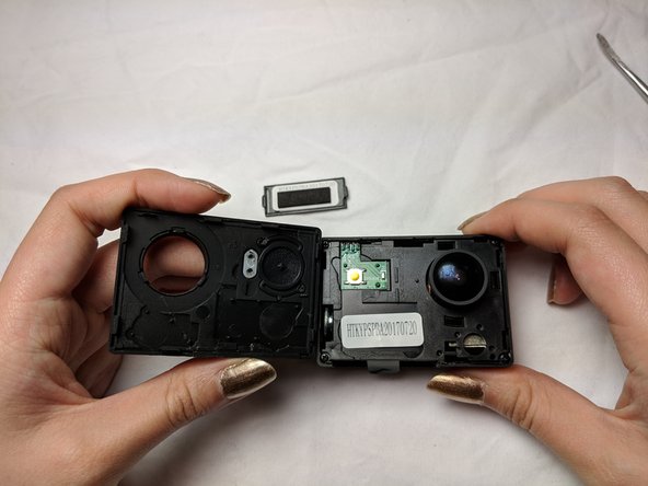

    1. Akaso EK7000 4K Button Replacement, Button: crwdns2935265:05crwdnd2935265:01crwdnd2935265:02crwdne2935265:0 Akaso EK7000 4K Button Replacement, Button: crwdns2935265:05crwdnd2935265:02crwdnd2935265:02crwdne2935265:0
      • Using a Phillips #000 screwdriver, remove the four screws securing the cover plate.

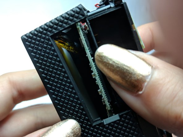

    2. Akaso EK7000 4K Button Replacement: crwdns2935265:06crwdnd2935265:01crwdnd2935265:02crwdne2935265:0 Akaso EK7000 4K Button Replacement: crwdns2935265:06crwdnd2935265:02crwdnd2935265:02crwdne2935265:0
      • Using your thumb or a spudger, gently push up from inside the battery cartridge.
      • Gently lift the cover plate until you can see into the inside of the camera. The cover will not completely come off, so be careful not to damage any of the inner wiring.

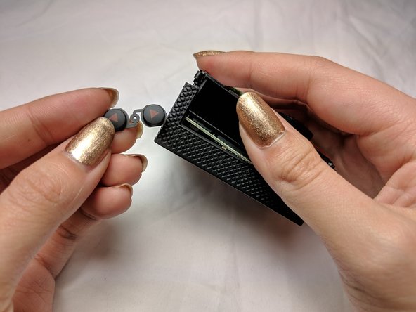

      • Using the metal spudger, push down on the up and down button as shown in the picture. Dislodge the button and it should fall to the bottom of the camera.
    4. Akaso EK7000 4K Button Replacement: crwdns2935265:08crwdnd2935265:01crwdnd2935265:02crwdne2935265:0 Akaso EK7000 4K Button Replacement: crwdns2935265:08crwdnd2935265:02crwdnd2935265:02crwdne2935265:0
      • Again, using the metal spudger, gently pull out the button from within the camera.
