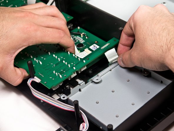

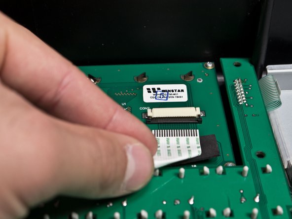

    • Using two plastic opening tools, slide the black locking mechanism on the ZIF connector towards you. This will remove the ribbon cable connecting the motherboard to the screen.
  8. Akai MPK25 Selector Knob Replacement: crwdns2935265:08crwdnd2935265:01crwdnd2935265:02crwdne2935265:0 Akai MPK25 Selector Knob Replacement: crwdns2935265:08crwdnd2935265:02crwdnd2935265:02crwdne2935265:0
    • Wiggle and pull out the ribbon cable connecting the mother board to the beat pads.
