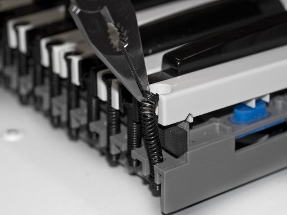

    1. Akai MPK25 Keys Replacement, Keys: crwdns2935265:06crwdnd2935265:01crwdnd2935265:02crwdne2935265:0 Akai MPK25 Keys Replacement, Keys: crwdns2935265:06crwdnd2935265:02crwdnd2935265:02crwdne2935265:0
      • Using needle nose pliers, grip the top of the spring coil, that is holding down the key, and gently lift the spring away from the key.
    2. Akai MPK25 Keys Replacement: crwdns2935265:07crwdnd2935265:01crwdnd2935265:01crwdne2935265:0
      • Lift the key from the front of the keyboard towards the back in order to remove it completely.
