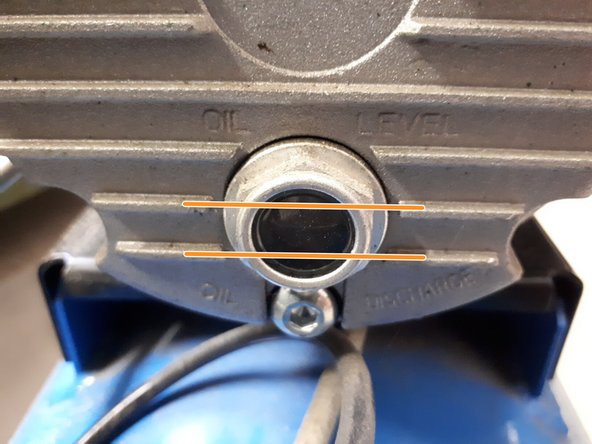

    • To ease the draining process, run the compressor for a few minutes and warm up the oil a bit.
    • Make sure to unplug the compressor at this point.
    • Unscrew the filler cap to allow air into the reservoir.
  2. Airpress LM 50-350 Oil Replacement, drain the oil: crwdns2935265:02crwdnd2935265:01crwdnd2935265:02crwdne2935265:0 Airpress LM 50-350 Oil Replacement, drain the oil: crwdns2935265:02crwdnd2935265:02crwdnd2935265:02crwdne2935265:0
    • Using the 5mm hex key, unscrew the drainage plug.
    • With the plug removed, let the reservoir drain until no more oil comes out.
  3. Airpress LM 50-350 Oil Replacement, add oil: crwdns2935265:03crwdnd2935265:01crwdnd2935265:02crwdne2935265:0 Airpress LM 50-350 Oil Replacement, add oil: crwdns2935265:03crwdnd2935265:02crwdnd2935265:02crwdne2935265:0
    • Screw the drainage plug back on.
    • Add the new oil through the filler hole.
    • Make sure the oil level on the indicator is between the lines.
