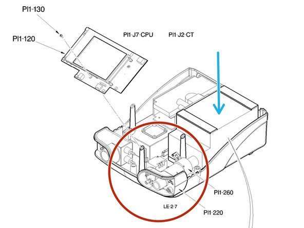

    • Open the device by removing the five attachment screws (Pl1.20) on the bottom casing side (Pl1-280). Lift off the top outer panel.
    • Carefully separate the two casings to avoid tearing off the keypad connections.
  6. Airox Legendair Turbine Box Replacement: crwdns2935265:08crwdnd2935265:01crwdnd2935265:01crwdne2935265:0
    • Unscrew the three attachment screws (Pl1-130) for the CPU board (Pl1-120).
  7. Airox Legendair Turbine Box Replacement: crwdns2935265:09crwdnd2935265:01crwdnd2935265:01crwdne2935265:0
    • Disconnect all connectors Pl1.J1.CT, Pl1.J2.CT of the turbine control board.
  8. Airox Legendair Turbine Box Replacement: crwdns2935265:010crwdnd2935265:01crwdnd2935265:01crwdne2935265:0
    • Extract the turbine casing (Pl1.50) from its housing and uncouple the flow rate measurement block (Pl1-260), the O2 supply pipes and the piezo solenoid valve.
  9. Airox Legendair Turbine Box Replacement: crwdns2935265:011crwdnd2935265:01crwdnd2935265:01crwdne2935265:0
    • Place the turbine box (Pl1-50) in a clean and open environment
    • Remove the four screws, washers and spacers (Pl1.70, Pl1.80, Pl1.90) in order to successfully extract the turbine control board (Pl1.60).
  10. Airox Legendair Turbine Box Replacement: crwdns2935265:012crwdnd2935265:01crwdnd2935265:01crwdne2935265:0
    • Disconnect the box from the turbine control board (Pl1.J6.CT).
  11. Airox Legendair Turbine Box Replacement: crwdns2935265:013crwdnd2935265:01crwdnd2935265:01crwdne2935265:0
    • Replace the turbine box (Pl1-50).
    • Replace the turbine control board (Pl1.60) on the box with four screws, washers and spacers (Pl1.70, Pl1.80, Pl1.90) (Torque 5 Nm max.).
  12. Airox Legendair Turbine Box Replacement: crwdns2935265:014crwdnd2935265:01crwdnd2935265:02crwdne2935265:0 Airox Legendair Turbine Box Replacement: crwdns2935265:014crwdnd2935265:02crwdnd2935265:02crwdne2935265:0
    • Connect the box to the turbine control board (Pl1.J6.CT).
    • Couple the flow rate measurement block (Pl1-260) to the casing and connect the two O2 supply pipes and the piezo solenoid valve.
    • Then, reinsert the assembly into its housing. Put the cone support (Pl1-50) into place. Put the additional cone support (Pl1-220) also into place.
  13. Airox Legendair Turbine Box Replacement: crwdns2935265:015crwdnd2935265:01crwdnd2935265:01crwdne2935265:0
    • Reconnect all connectors (Pl1.J1.CT, Pl1.J2.CT) to the turbine control board.
  14. Airox Legendair Turbine Box Replacement: crwdns2935265:016crwdnd2935265:01crwdnd2935265:01crwdne2935265:0
    • Reinstall the CPU board (Pl1-120) with the three attachment screws (Pl1-130) (Torque 5 Nm max.)
    • Close the device again, taking all necessary precautions (see Step 2-3)
Perform a final inspection of the device before putting back into service.
