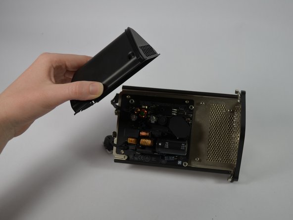

  8. AirPort Extreme A1521 Power Supply Replacement, Power Supply: crwdns2935265:08crwdnd2935265:01crwdnd2935265:02crwdne2935265:0 AirPort Extreme A1521 Power Supply Replacement, Power Supply: crwdns2935265:08crwdnd2935265:02crwdnd2935265:02crwdne2935265:0
    • Remove the four 10.35 mm Torx T8 screws on the black plastic shell.
  9. AirPort Extreme A1521 Power Supply Replacement: crwdns2935265:09crwdnd2935265:01crwdnd2935265:01crwdne2935265:0
    • The power supply should come right off.
    • Make sure you don't touch the black cylinder on the power supply. It can shock you and cause injury.
