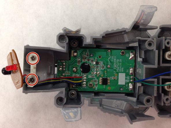

  9. Air Hog Smash Bots Radio Receiver Replacement, Radio Receiver: crwdns2935265:09crwdnd2935265:01crwdnd2935265:02crwdne2935265:0 Air Hog Smash Bots Radio Receiver Replacement, Radio Receiver: crwdns2935265:09crwdnd2935265:02crwdnd2935265:02crwdne2935265:0
    • Use the Phillips 0 screwdriver to remove two 4.75mm screws.

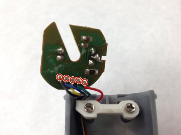

  10. Air Hog Smash Bots Radio Receiver Replacement: crwdns2935265:010crwdnd2935265:01crwdnd2935265:02crwdne2935265:0 Air Hog Smash Bots Radio Receiver Replacement: crwdns2935265:010crwdnd2935265:02crwdnd2935265:02crwdne2935265:0
    • Use the soldering workstation to remove the five wires. Directions on how to solder can be found here.
