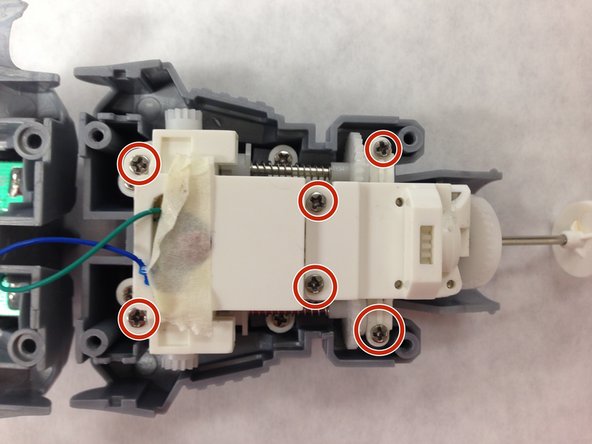

  9. Air Hog Smash Bots Motor Replacement, Motor: crwdns2935265:09crwdnd2935265:01crwdnd2935265:02crwdne2935265:0 Air Hog Smash Bots Motor Replacement, Motor: crwdns2935265:09crwdnd2935265:02crwdnd2935265:02crwdne2935265:0
    • Using the Phillips #0 screwdriver, remove six 4.75mm screws.
  10. Air Hog Smash Bots Motor Replacement: crwdns2935265:010crwdnd2935265:01crwdnd2935265:01crwdne2935265:0
    • Use the soldering iron to remove the blue and green wire from the motor casing. Directions on how to solder can be found here.
