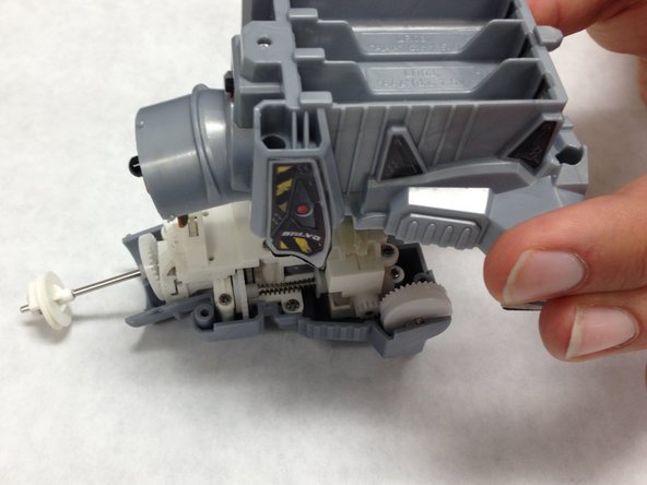

  6. Air Hog Smash Bots Motherboard Replacement: crwdns2935265:06crwdnd2935265:01crwdnd2935265:01crwdne2935265:0
    • Hold the upper body and slide out the bottom half of the Smash Bot.
    • The motor extends from the lower-body into the upper-body. Be careful to not damage the motor.

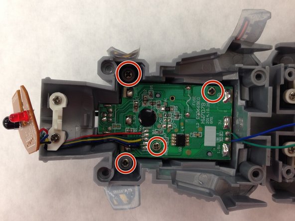

  9. Air Hog Smash Bots Motherboard Replacement, Motherboard: crwdns2935265:09crwdnd2935265:01crwdnd2935265:02crwdne2935265:0 Air Hog Smash Bots Motherboard Replacement, Motherboard: crwdns2935265:09crwdnd2935265:02crwdnd2935265:02crwdne2935265:0
    • Remove four 4.75mm screws from the motherboard.

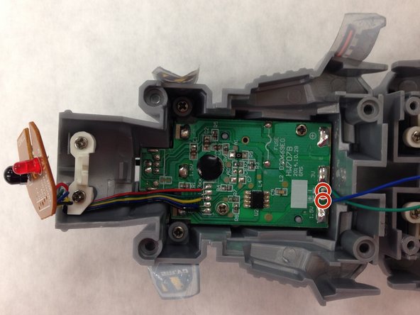

    • Use the soldering iron to remove the two wires from the motherboard. Directions on how to solder can be found here.
