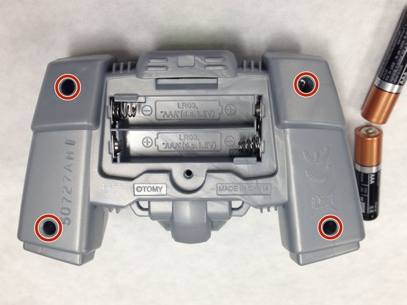

    • Take out your controller and access to the back of the controller.
  2. Air Hog Smash Bots Front Panel Replacement: crwdns2935265:02crwdnd2935265:01crwdnd2935265:01crwdne2935265:0
    • Remove the screw on the battery lid. Using the Hex 4 socket and PH #0 bit, remove the 8 mm screw.
  3. Air Hog Smash Bots Front Panel Replacement: crwdns2935265:03crwdnd2935265:01crwdnd2935265:01crwdne2935265:0
    • Remove the 2 AAA batteries.
  4. Air Hog Smash Bots Front Panel Replacement: crwdns2935265:04crwdnd2935265:01crwdnd2935265:02crwdne2935265:0 Air Hog Smash Bots Front Panel Replacement: crwdns2935265:04crwdnd2935265:02crwdnd2935265:02crwdne2935265:0
    • Using the Hex 4 socket and PH #0 bit, remove the four 8 mm screws on the panel.

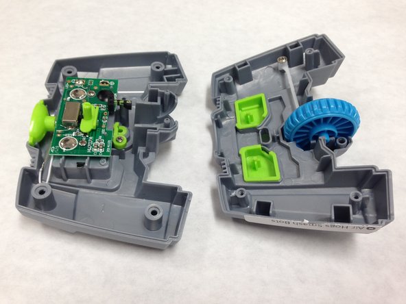

  5. Air Hog Smash Bots Front Panel Replacement: crwdns2935265:05crwdnd2935265:01crwdnd2935265:02crwdne2935265:0 Air Hog Smash Bots Front Panel Replacement: crwdns2935265:05crwdnd2935265:02crwdnd2935265:02crwdne2935265:0
    • Use the plastic opening tool to disconnect the front and back parts of the panel.
    • Some of the internal components may be displaced when opening the controller.
